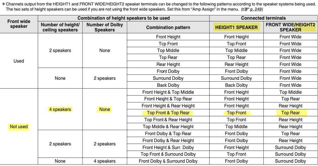

Actually I need some clarification here.., I had made a note of the speaker connections before sending the AVR for repair.
The REAR LEFT HEIGHT was actually connected to the HEIGHT 2 LEFT on the AVR.
If thats the case, will it still Reassign the FRONT LEFT to drive the Rear Left Height ? Arent those separate dedicated channels or they sharing the same o/p circuit(transistors) on the board ?
@PENG , can you pls clarify my question above.., Thanks
Assuming these are dedicated channels, then the REAR LEFT HEIGHT B&W speakers connected to HEIGHT 2 LEFT terminals on the AVR, wouldnt have blown the FRONT LEFT transistors? , unless they're sharing the components on the board for whatever reason.
Is there a reason for Marantz to reassign the FRONT LEFTs to REAR LEFT HEIGHT, when there is a dedicated HEIGHT 2 LEFT channel, to which I have connected, for the Height channels.

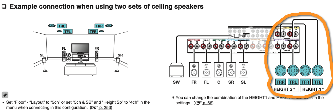

I am not sure if I understand you question correctly. If your rear left height B&W speaker was connected to the "HEIGHT 2 LEFT" terminals on the AVR" then it was connected to the Front left output transistors as I thought you have also confirmed that the "Pre-outs" were set to "Front" in the amp assign menu. That collaborates well with the fact that the front left output transistors were the ones blown twice. Am I missing something?
Edit: I think I understand your point now, please read the Owner's instruction manual page 70:
You can see that the "dedicated" amps for FWR/FWL could have been set to FDR/FDL, ie. Height 1, so the Height 2 would be connected to the FL/FR. Again, a photo of the amp assign setting may help clarify this.

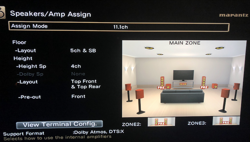

It may help clear things up a little if you post a photo of your amp assign setting screen. Just so you know what I am referring to, below is mine. I don't have the luxury to mount them in the ceiling, but I hang them from the ceiling so they are still more "top" then "height".
You can see that the way I have it set up, my top rear speakers are in fact connected to the "HEIGHT 2" terminals. I bet yours ("rear height" in you case) were/are too.

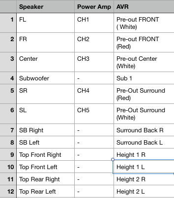

@PENG , when I say HEIGHT 1 & HEIGHT 2 , I mean the speaker terminals on the AVR, thats what they're named. I didnt use the actual Height channels, but Height 1/2 connected to TOP FRONT & TOP REAR Speakers..
, as outlined on page 60 of the manual, but with the Surround backs included,
So HEIGHT 1 from AVR went to Top FRONT L/R & HEIGHT 2 went to TOP REAR L/R , as shown above.
Page 70 refers to two sets of "Dolby Atmos Speakers" , which dont apply to me. These are not Atmos enabled speakers("bouncy house" as Gene calls them), but regular speakers mounted on ceiling.
Unfortunately, looks like the AVR repair has reset all the configurations to default. I need to do them from scratch. I just have the physical connections noted , before I sent to repair ..and these were the Connections and yes , like yours, my Top Rears are connected to Height 2:
In the Amp assign section, Floor layout would have been set to "5Ch & SB" for 7.1 Channels and "Height Sp" to "4Ch" , for the ceiling speakers.
from Page 66 of the manual, highlighted my Config.
Now I have a question for you. Those B&W speakers are ceiling mount speakers and I assume you did install them in the ceiling. So why did you select "Heights" instead of "top"?
No , I didnt select HEIGHT, but TOP FRONT, TOP REAR , as shown above.
Thanks much, for your time on this..

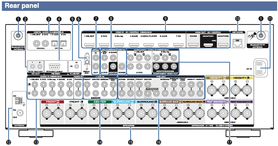

So it seems that you had yours set up like mine as we both use the top front and top rear configuration. That means your top rear left speaker was in fact connected to the front left channel amp.
By the way, I picked page 70 only because that's the first page I came across when doing a test search and that page (page 68 too, in fact would have been clearer to you) sort of implied the default setting as it shows the external amp connection. From the picture on either page we can reasonably assume the default "assign" is set up such that the labelled "HEIGHT 1" terminals are "live" while "HEIGHT2" are are not, until you use the "assign" functions. In your case, it means "HEIGHT2" are connected to the front channel amps. As I said the manual was confusing the way they described the assign functions. I don't blame the writer because it really is complicated by nature. With so many configurations, we pretty much have to ignore the FWL, RDL, RHL, RTL and just consider them as HEIGHT1/HEIGHT2 to avoid getting confused.
The simple fact is, the SURROUND BACK and FRONT WIDE/HEIGHT2 terminals as labelled, are both assignable, as are the FRONT L/FRONT R in reality if you set them to "PRE OUT". As such, there isn't really "dedicated" amps for those as some may be led to believe. There is however, what I would call the "default" amps for those terminals, and that would be valid under "factory set up", or after a processor reset conditions.
Edit: deleted my comments about the banana plugs, it's irrelevant.
Once you get it set up again, I would appreciate if you don't mind posting the same screen shots I did in post#25 as I am interested to see how similar the amp assign setup screens of your 2015 Marantz and my 2017 Denon would be.

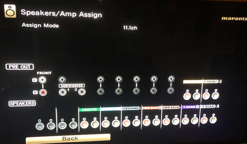

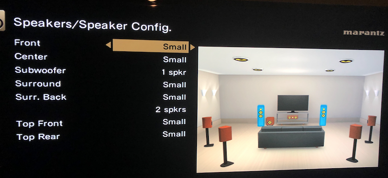

@PENG , here are the screenshots from the Marantz Amp Assign/Speaker configs - same as before , except I havent connected the speakers yet .
Now can we rule out setup error ;-) ? .., a configuration that I didnt touch for a couple of years now since 7.1.4 went live (started with 7.1 on this Marantz about 4 yrs ago)
So we're saying, although not stated or implied in the manual, the HEIGHT 2 ( conected to TOP REAR) , implicitly got reassigned to FRONT LEFT , even though I've freed up 5 of amps by pre-outs? This has 9 amps and I used up only 6 of them from Marantz ( & 5 from Emotiva). So HEIGHT2 doesnt have a dedicated amp and got defaulted to FRONT LEFT behind the scenes and that doesnt get called out in the Amp Assign screens or manual.
The closest I saw in the manual , about the usage/reassignment , was in Page 66 , that states
but no mention of FRONT LEFT reassignment.
If thats the case, does explain the concurrence of TOP REAR LEFT speaker loud pop and Marantz going to protection mode and repair guy mentioning FRONT LEFT transistors, on the first incident. On the 2nd incident, after repair, it was just AVR starting up with DEFAULT Amp Assign/Speaker configs , after Emotiva came up via the DC 12v trigger.
Yes yes and yes..like I said earlier, the manual(s) are not clear and missing details. If you didn't change anything by default you are feeding the rear top left with the front left.
To triple check (since yours an older Marantz, don't want to assume it's the same as my newer Denon), I downloaded the schematics and that confirmed my assumption/understanding is correct.
You can download the schematics too if you wish.

I can tell you those Dayton speaker testers are excellent at uncovering even the most subtle VC problems.
My concern is that unless you are very careful then you may keep going round in circles. Don't be surprised if the Marantz is more fragile than the older Denon..
You seem to have a nice system. I would strongly advise you to move up to a Marntz pre/pro and use dedicated power amps to each speaker.
I personally use Quad amps. That is because they are designed from square one to be highly robust and tolerant of a wide variety of loads. Even so I take great care NOT to put protection to the test.
I agree the speaker could have been damaged and need to be checked but disagree on the 100 V thing, let's not exaggerate too much.
