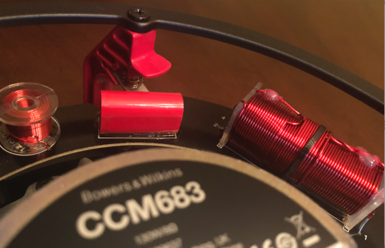

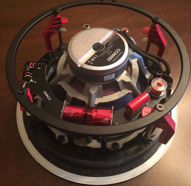

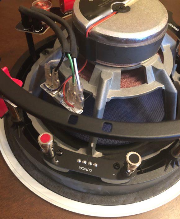

Just took the bad boy out.., dont see any burnt marks anywhere
Looks good! Seems that it is now down to two things: a) the speaker feed wires have a fault that is somehow intermittent, or b) the receiver has an intermittent internal fault that the service tech missed, it is easy to miss if the fault did not reveal itself at the time.
What kind of speaker wires did you use? Is it the regular type that if pinched the right way, a short could be created?
I dont want to void the warranty..and its working fine.. you could see most of it anyways, no signs of damage.
You can see most of the innards of the speakers from the outside? I can look inside a speaker without anyone knowing but me in any case....and have done so as warranty claim is something I've never had to use on a speaker....
AVUser001
AVUser001
Yes, I have special glasses ;-) , Seriously, dont want to, to go along this line of diagnostics. Appreciate your suggestion, anyways.
