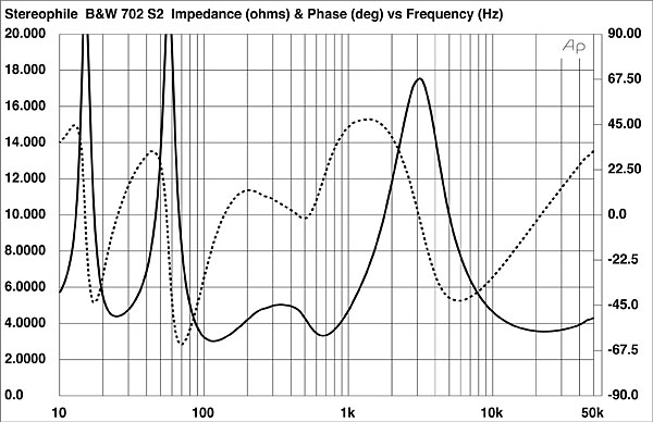

Here is the impedance curve of a B & W 702 speaker with phase angles.
Note that in a good deal of the power band, this speaker is in fact three ohms. Now look at 70 Hz where the impedance is around 4 ohms but the angle between phase and current is over 60 degrees negative. A that point the current demand is enormous and will blow up any receiver currently on the market.
If you persist in driving those speakers with a receiver you will blow any of them up and they will have a short life span.
So your solution is powerful and robust external amplification. With those speakers you have no other choice. You need to stop driving those speakers with that receiver now, or I can guarantee you will ruin it.
