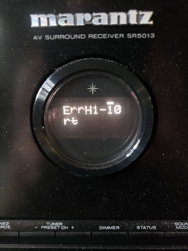

Hello , i have a marrantz sr5013..
I have only had it a short time...
Issues stsrted with my old vizio tv and cable box on super bowl. Stsrted intermittently losong video, so i replaced cable box and every single hdmi cord i have
So i thought i fixed the problem,
In between this time i bought a new Samsung q60 75" , set everything up on arc etc.. then it start periodically just shutting off.. tv and avr
So im thinking my brand new tv is wonky..
Well yesterday 4/6 watching spiderman blueray on my 4k player (NOT 4K) and it stsrted doing the intermittent sound and video loss.
Now my hands are in the air and im getting pissed. I have 3500$ in cables and equipment only to still be experiencing same issue.
So accessories4less service tells me to run hdmi diagnostics...
I get an error says contact support... ERRH1-10
I call marrantz and of course they have me do cliche troubleshooting power cycle, un plug this un plug that , are my cables goood yada yada...
Then he tries to say its my power outlet and i dont have enough ventilation mind u i have 5" over top , 3 on each side....
Does anyone here have a clue as to what the deal is? According to a page i found errh-10 is hardware failure.. is this accurate.

Hopefully, PENG will jump in or LTHD they can help for sure. But since your getting a code I believe your right your AVR has a issue for sure.

I didn't find anything specific, but coincidentally that's the same code they use for an example in the manual.

Yea, marantz guy didnt have a clue , it was obvious. Now i have to call back and escalate it

IMO, ARC seems to be a real pain in the butt. I would suggest bypassing that feature and use the usual HDMI connections. WHO NEEDS ARC? IT'S A LOT EASIER WITHOUT IT!
Seems you're beyond the 30 day return period A4L offers, so then the only real choice is to go to Marantz and escalate for warranty relief. Have you run microprocessor reset? Didn't see that mentioned. Sometimes its suggested to run it several times.

I have not done that... is it basically a master reset?

Pretty sure its its hardware failure happening at this point.
It still works, luckily marrantz said they have technicians local so they can send someone over mailing it.

Never heard that one before, where are you?
Well I can not find what that error code signifies. I would not assume it is the receiver, but probably is. However Samsung TVs are well known for HDMI ports not following the rules. So there is a good possibility the error code relates to a communication issue. Personally my opinion is that a Samsung TV should never be purchased.

Normally i would agree, however the same issue happened with my vizio as well. Not Samsung alone, so that in turn leads me to believe its not a tv issue.

Near atlanta.

Interesting, was thinking you might be up near Panurgy or something. Curious who reps them in your area....and hopefully the tech can figure it out for you.

I hope so, marrantz did say if push comes to shove, i still have my warranty for replacement.
I did notice however marrantz is like a space heater regardless the impedance of my speakers or volume of my listening habits.
I ordered an ac infinity fan to couple this potential issue for future problems

I think adding cooling to avrs these days is a good move.
