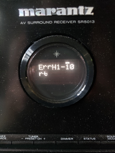

Did McIntosh ever make an avr? Can't think of anyone else that might have. 2ch receivers, some. I'm west coast, TLS is in Minnesota.
Did it overheat or run very warm? What temperature was it? OTOH Marantz didn't actually rate it at 4 ohm either.
No mine hasn't yet. Just the hdmi diagnostic error "errh1-10 "
