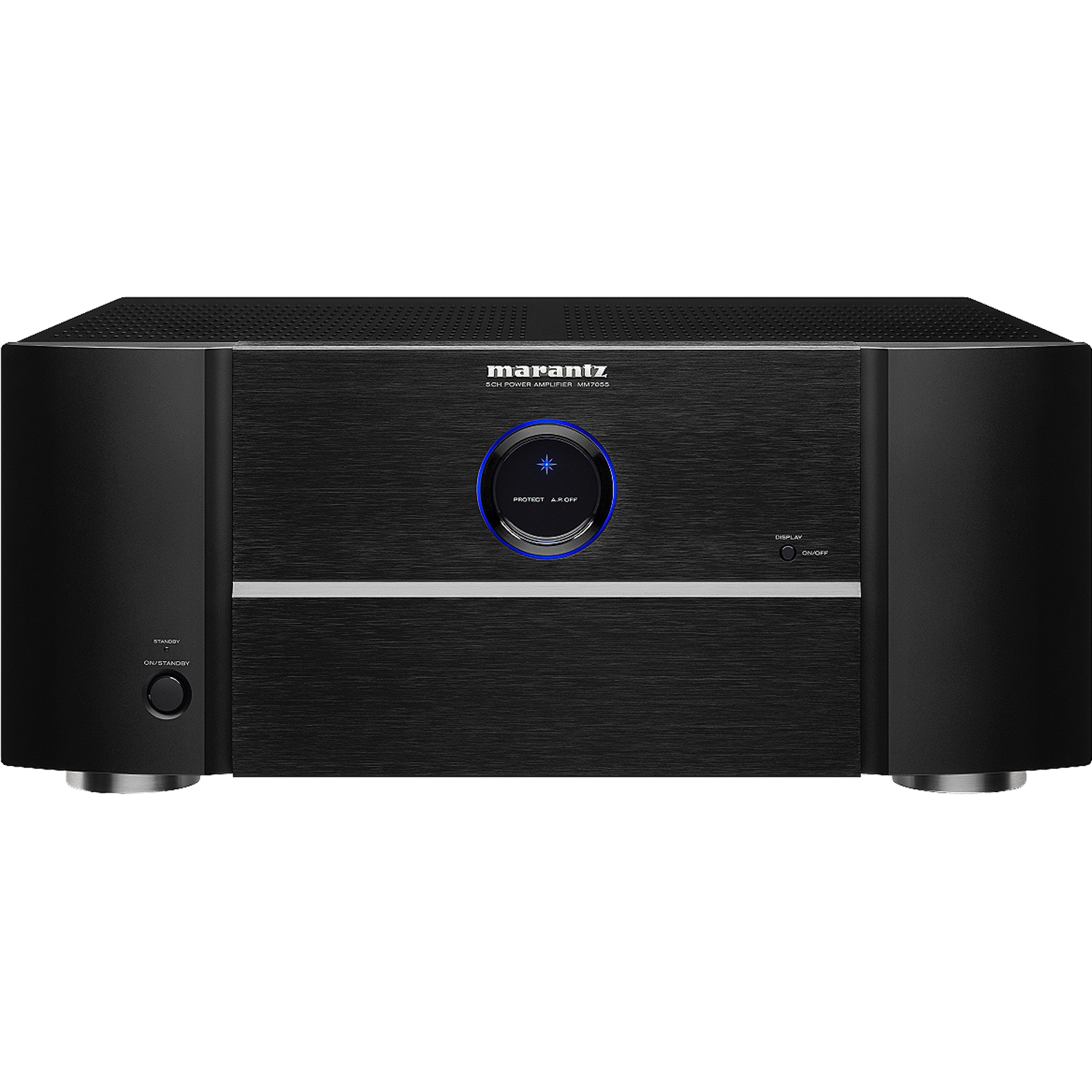

I would go with the Marantz. It is definitely less powerful, but the difference won't be any more than 1.5 dB or so. The RF-7III and RC-64III have good sensitivity, specs say 100 dB/99 dB so you should be able to count on 94/93 dB. The Marantz is much lighter and the look would match the receiver, and is brand new.:D

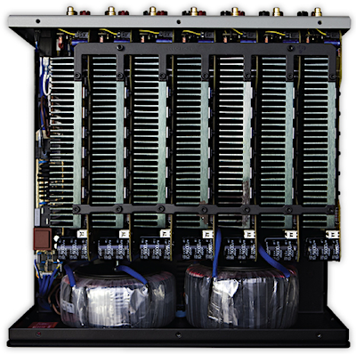

Monolith 7x200 vs MM8077 = 48lbs more or twice as much weight in the Monolith than the MM8077.
Marantz MM8077 looks totally different than the tight Monolith 7x200 layout.

Agreed... I doubt the Marantz provides 150 watts per channel with all 7 channels running. Look at the power consumption. At maximum load the amplifier draws 880 watts from the power supply, which may correspond to just under 100 watts per channel after you account for heat loss. It's still better than most receivers but probably only half the power offered by the Monolith 7x200 running all 7 channels. Maybe those extra 48 pounds actually do something? :p
