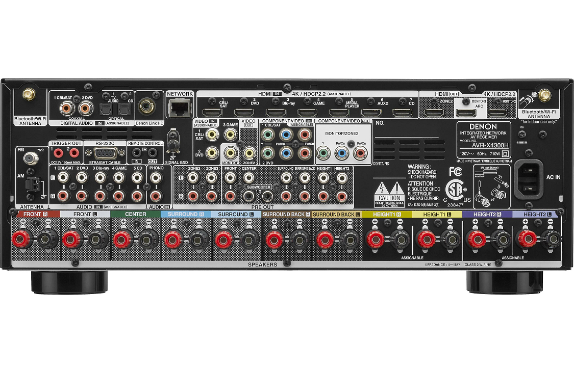

Except it has 9 amps of which unused channels cannot be reassigned. So, one it only power 2 height channels at a time. To get all 4 heights going, an onboard 2 channel amp is required :mad:.
What am I missing? It looks like it has speaker connectors for 11 channels. Four for height.
everettT
everettT
Because only 9 channels of amplification, non assignable
The X4300 has a total of 9 Ch of Internal Amps, 7Ch for FR, FL, C, SR, SL, RR, RL. These 7Ch of amps cannot be assigned to be used for the Heights.
There are only 2 Internal Amps left to use for the Heights. You can only use 2Ch of the Height Channels, not all 4Ch with the Internal Amps of the X4300.
If it had a total of 11 Ch of internal amps, you could use all 4 Heights.
So then you would have to use an external amp for the other 2Ch of Height.
The user picks which of Height 1 or Height 2 the AVR will power. Having 11 binding posts is for user friendly design of not having to unplug and replug different height speakers. From the Denon X4300H page,
So, 7.2.2 or 5.2.4 with internal amps alone. I misspoke about not being able to power 4 heights simultaneous. IMO, a technicality since an external 2ch amp is needed for 7.2.4 whether one chooses to use it for rear or height channels.

What is frustrating is that not-assignable amps is 100% a forced limitation via software. I just don't understand why. Surely no one in the right mind would buy the next higher AVR for 2 internal amps.

Not knowing the user interface, are the amplifier assignments tied to the pre outs? In other words can you set the pre outs to 7.2.4 and redirect the two rear surrounds to the 2nd height?
If not, I suppose I could live with the something like;
Front left & right - XPA-1s (pre-out)
Center, Surround left & right - XPA-3 (pre-out)
Rear left & right - X4300H rear
Front Height - X4300H front height
Rear Height - XPA-2 (pre-out)
The XPA equipment is existing Emotiva amplifiers.

I don't have it, but, the GUI has not changed appreciably since the X4000. Amp Assign is the first step in auto setup, before running Audyssey.
Yeah, the amp assignments are fixed/ unchanged within the confines of these options, http://manuals.denon.com/AVRX4300H/NA/EN/DRDZSYasydxfyy.php#
AVR amp channels can be diverted to Zone 1 LR bi-wire or Speaker B or a Zone 2 LR, at the expense of having them available for Main Zone rear or height speakers.
The pre-outs on the other hand, are somewhat independent of amp assignments. They can be set to, Main Zone (7.2.4), Zone 2 (2.0) and Zone 3 (2.0). So, that external amp arrangement will be achieved without any hassle.
