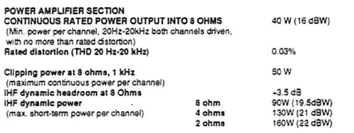

I had a NAD 705 that far exceeded its specs. Rated at 40 watts at 8ohms, someone bench tested it and it was stable at 1ohm at 292 watts.
PENG
That's very interesting, enough to make me search for it's specs and found the following:
So, as expected, NAD indulge in the IHF dynamic power that generally means the duration would be limited to 20 millisecond.
Yamaha does the same thing and per their website:
To measure dynamic power, an amplifier is fed a 1000 Hz signal for 20 milliseconds then allowed to rest for 480 milliseconds.
NAD uses the same standard so it would be the same.
An amp that measured under such standard does not mean it would output the measured as "stable", not for 20 ms obviously.
Also note that the amp weighs only 14 lbs, 1 ohm, 292 W would mean 17.1 amperes! It it could actually do that, it would be for very short duration, even less than 20 ms for sure. Still such NAD amps (again, like Yamaha) are known to do well under very short durations.
And I learned something new, thanks. It would be nice if more companies would design and rate their equipment similarly. Obviously not continuous power but it shows solid engineering
Nice - circa 300W at 1ohm is roughly the theoretical doubling for each halving of impedance from 40W@8ohm.
However, I would bet that the 292W@1ohm was for a short period - and not a continuous reading...
My Quad 606 can do 40W@1ohm continuous but more than 90W@1ohm peak....
292W would require circa 17A... and I doubt the NAD 705 could provide 17A continuously.... although briefly from the capacitor reserves, certainly. (period reviews do mention the 705 doing 160W into 2 ohm for brief transients).
