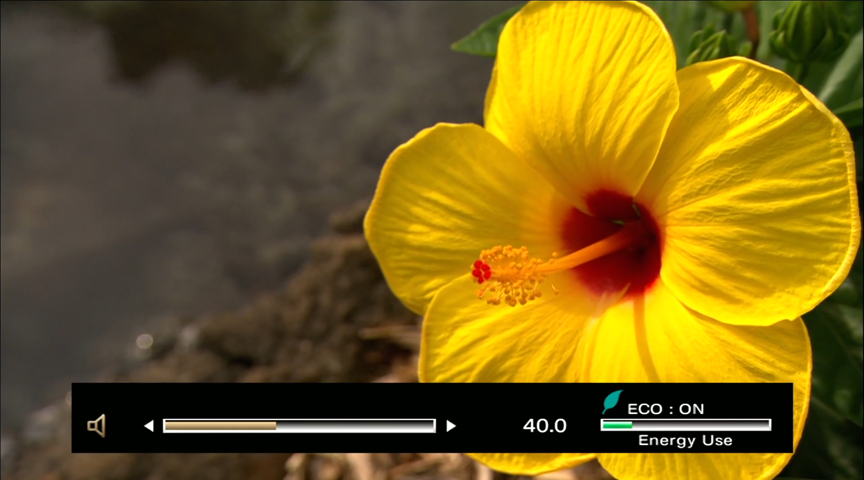

I ordered one of the Marantz NR-1605 slim receivers from A4L. One of the features is "Eco Mode".
Our new advanced Eco amplifier mode adjusts power consumption according to signal level, and there's an on-screen Eco Mode display that lets you see the power consumption reduction in real time.
I have done a couple of Google searches and really cannot find out much about it.
One forum had a similar question and the only useful info was one guy stated that his AVR ran 10 degrees cooler with it on.
It has On, Off,and Auto settings. I do not want to be bothered with needing to turn it on or off depending on whether I am just putting music into my house (On) or doing loud and/or critical listening (Off). So I would leave it off. However, if the auto setting is well designed, that would be great!
Does anyone know much of anything about it?
TIA!

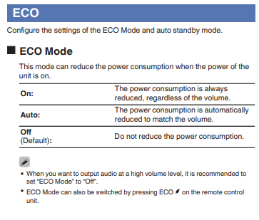

From my Marantz manual. Personally I do not have heat issues since the AVR is out in the open, so no need for a fan. I cannot remember the exact point Auto switches over (somewhere around -30 to -20 I believe) but that or OFF are probably your best options. Try it and see if you like, it has an on screen indicator
I posted the original avs link on this topic before more than once, but the one below (please scroll down to post#23) should answer more questions, hopefully..
https://forums.audioholics.com/foru...d-need-some-advice.112870/page-2#post-1276426
I am not sure if it varies slightly among different models, mine switched over at volume -42. It is not hard to find out, you just need to be patient because there is a time delay and need to be refreshed manually (the OSD has to turn off and on) each time you advance the volume by 0.5 dB.
It would be a very poor design that had a specific volume for Eco Auto/On. As it is, you can manipulate the overall volume by adjusting the individual source levels, the speaker levels and the output levels in addition to the main volume control. You can also limit the range of the volume control both to initial and peak . The Eco mode works off a threshold of power usage. Denon/Marantz could probably tell you an exact figure, but while it relates to volume it is not a specific figure. It relates to how many watts are being used at any point, what amps are active and driven, the specific source and if more that one zone is active simultaneously.
If the AVR was only acting as a processor and the amps are off or set to external, then in all likelihood the Eco mode would never switch, regardless of the volume setting. Using the Eco mode has just one real problem and that is if you are around the transition point with the volume then it will likely toggle repeatedly depending upon the signal source. There is probably a margin above/below for it to engage or disengage.
PENG
Ratings
5,085 7 1
#18
The auto mode based on volume setting is a poor design, but to me, it is better than nothing. The ECO "ON" mode is 100% functional when the internal amps are not used.
