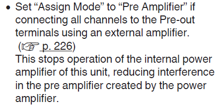

You are correct about this, only the Denon AVR-X8500H has the "assigned" as pre amplifier. On page 81 of the Owner's manual, it says:
The Marantz SR8012 and Denon AVR-XX6500H do not have this "amp assign" feature.
