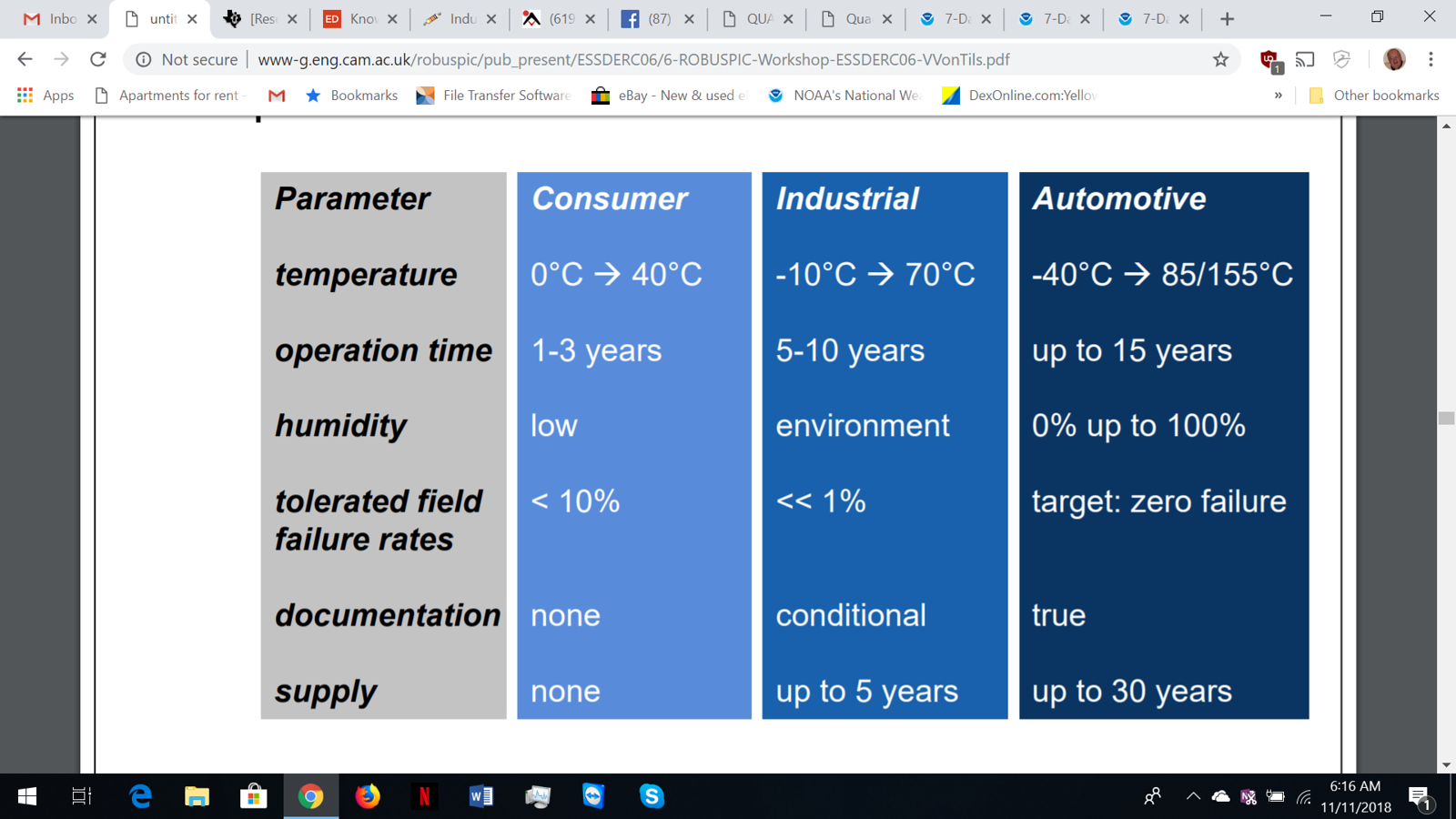

I have this screen shot from a Bosch technical pdf.
As you can see it also covers humidity (a big factor),field failure rates, and the time it must stay in the supply chain.
Now you can see consumer grade has a component failure rate of up to 10%. Well when you scale this up to the number of components in a receiver you see the problem. It gets worse as complexity, like all the streaming options and ATMOS, UHD 4K etc. are added.
In the above shot consumer would be grade 4 and industrial grade 3. The automotive spec shown above would be automotive grade 0.
These are the AEC-Q100 grades. As you can see the ambient temp. spec. is the only one quoted, but it is much more than that.

I would certainly support these measures. In my view reliability and longevity are at unacceptably low points.
Lastly out of curiosity and interest we have medical grade, the highest standard of all. If you read this, you will see why medical electronic equipment is so expensive.
Ratings
7,272 19 6
#19
In terms of reliability, whether it’s AVR or Pre-Pre, I think it’s about how much crap they horseshoed in the chassis, quality of parts (i.e. HDMI boards and other circuits) and the quality control/testing.
Well, just don’t spend too much money on any of these components to be safe.
If the Marantz still doesn’t work after repair, then next time get a Yamaha or Sony ES AVR.
