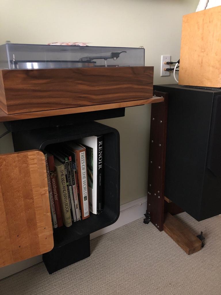

The upside: I don't have to be wondering about a fail point somewhere in the cross over. That center stage being shifted to the left is gone completely. I had my g/f yelling over the music at me. Life is good.
I guess I'll just have to listen to everything again to see what it sounds like wired up right. It took a surprisingly long time to identify that something was off. I level matched everything but just realized I have gain controls on the sub amps that need to be leveled to each other before they get leveled to the mains.
The YPAO auto set up set the speakers to large with a xo of 40 Hz to the subs with a bass out setting of Both and the subs are reverse phase. I guess I'll have to investigate those as well. You can never be too sure ...
The difference between YPAO's EQ and no EQ seems to be an added bass bump that effectively brings the top end down as Dennis mentioned doing in the hp filter with different sized resistors. No EQ sounds more forward for the vocals and brighter as a quick first impression. When YPAO's EQ pulls the vocalist back, it sort of creates a bigger sound stage. I'm gonna give this a go for a while. The subs are no longer even remotely localizable.
It's been an uphill battle with these things but I think I have turned a corner here *heavy sigh*

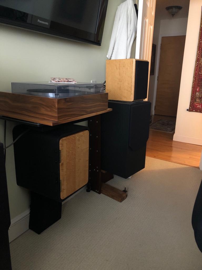

So I bi-amped the 3-ways 'cause I could. The rec'r allows for it with the surround back channels and some 'Advanced' menu, Maxwell Smart stuff you do on the rec'r's front panel. Yes, I was that bored and the rack is that easy to slide around on the carpet.
My tweeter is on it's own amp in this arrangement because of the way this was wired from the start and the fact that I placed a huge cap from the bandpass board onto the low pass board to even out the board sizes. Anyway the more sensible arrangement for a nonsensical bi-amping scheme would be the mid and tweet on one amp and the 10" woofer on another amp.
Maybe having the tweeter on it's own isn't a bad thing in light of the can of worms opened by the tweeter that stopped working. I keep playing with the xo point, polarity and LF distribution. Of course I accidentally wiped out the YPAO settings. I had the distances and levels in safe keeping on another memory setting. Going off my memory I made a couple of 1 and 2 db adjustments to fill in a perceived dry zone down low. Turns out my dry zone isn't my dry zone, it's the source that's different. My Dire Straits BIA is the 20th SACD anniversary edition but I was using a streamed 1985 streamed CD for comparison. Finally I decided to quit f^%&ing around and plugged the SACD in to see who's who. That changed things regarding the bass integration and over all balance or presentation of at least a couple of songs. It seems like you could spend a life time tweaking this and listening for that. No wonder people who are into audio are prone to nutty notions about what they can hear.
