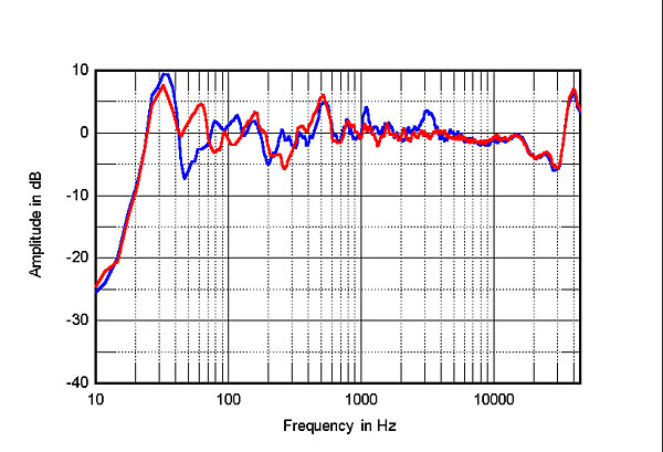

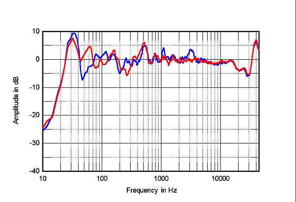

The Blade 2 in room should do okay down to 25 Hz if you can get some good room gain like JA's. The bigger original Blade should do a little better, I would think.. Without any room gain, it would probably drop more than 20 dB at 20 Hz but ADTG should still be able to hear the harmonics.:D
Fig.8 KEF Blade Two, 1/6-octave response in JA's room at listening position (left speaker blue, right red).
Irvrobinson
Irvrobinson
In the demo systems I’ve heard of the Blade and Blade2 they both had little or no discernible output with a 25Hz test tone or a 20Hz test tone. A 32Hz test tone was strong with both. It is possible that the lack of deep bass I heard was simply a room artifact both times, but I doubt it. Even in JA’s curve the bass response drops like a rock at about 30Hz, and 2nd order harmonic distortion plays a role in measurements like these and, unlike ShadyJ, JA doesn’t publish speaker distortion measurements. My conclusion was that the KEFs need at least dual subs and at least a 60Hz crossover frequency.
