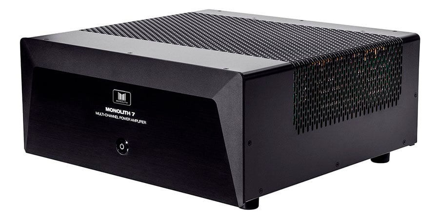

I have an ATI built Monolith 7 and it's performed flawlessly for me. They're very solid amps and should have more than enough power for your surround speakers all in one box. Of course you don't need the 7, but they have a 3 and 5 channel versions also. It reviewed very well here at Audioholics.
