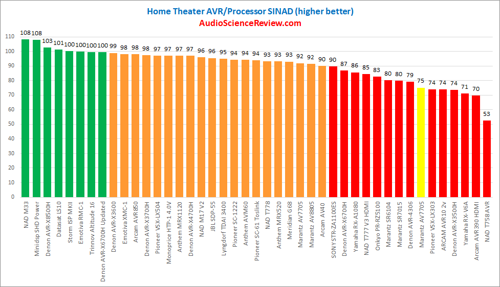

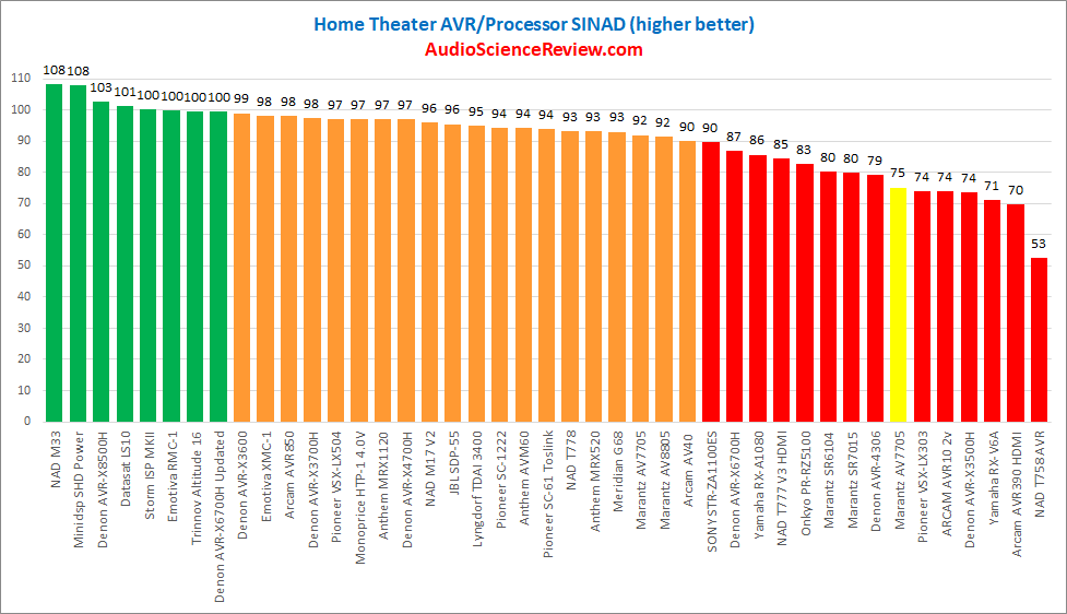

What are you using now anyway? And have you visit the ASR site to see the bench test performance? Below is the latest chart ranking by SINAD (THD+N):
Marantz AV7705 Review (AV Processor) | Audio Science Review (ASR) Forum
Edit: the first review I linked was incorrect, the correct is:
Note that the two units of the AV7705 have been bench tested, you can see that it ranks pretty low, the first one scored higher (92 dB SINAD) but that's measured at 1/2 the normal output voltage just to see if it did better at lower output, and it did. The normal standard is for 2 V RCA and 4 V XLR.

Thanks for the info. Interesting, NAD came out on top and the bottom. I used to use some NAD stuff back in my pre-multi-channel days. I had a C1700? preamp tuner, and a Power Envelope 2400 power amp. They were circa late 80s and sounded great with my La Scalas. The tuner in that NAD gear was 1st class; best tuner I have ever personally come across. I think the 2400 was at the start of the dynamic headroom marketing.
Good observation, that M33 is not really an AVR or AVP and I have no idea why Amir group it together with AVR/AVP in that chart.

With that made clear, I am going to focus on objective measurements. In my understanding, subjective measurements would be fine for those who believe that it is one's ears and brain that matter, not specs and bench tests/measurements.
I do not mean to pick on the AV7705, or the SR7015, but since it was you first pick so I am going to use them for reference in comparing specs and measurements. It also helps making the comparison fair and objective because if you are now leaning on a Denon AVR, you will be pleased to know that comparable Denon and Marantz models have virtually the same design, circuitry and componentry in their preamp/DAC signal path. The main difference is that Marantz, for whatever reasons (I suspect mainly a marketing strategy) keep sticking their so called HDAM at the end of the pre out signal path. That, I believe is the main reason for their much measured higher distortions and noise. I do not have the facts to support that, but if you compare their schematics/block diagrams, there seem to have no other logical explanation.
To make it easier to read and follow up on, I am going to use multiple but shorter posts. Now let's first look at distortions+noise based on the worse of the two channels (FL/FR) measured by ASR:
AV7705........................ 0.018%
AVR-X3700H............... 0.001348%
In terms of %, the AV7705, a so called separate processor is more than 13 times higher, or about 23 dB higher.
Counter arguments? Sure, how about the contents of the harmonics, may be Marantz's distortions are mainly of the lower order 2nd harmonics. Both AH and ASR do provide the FFT diagrams so one can take a look of the harmonic contents. Let's compare the two:
You can see the differences between the two are quite significant in terms of the contents of the harmonic distortions. Most people would consider even 0.1% distortions would be below the threshold of audibility, but the question is, would you prefer one that has 13 times higher distortions/noise and it costs 50% more?
More to come..
