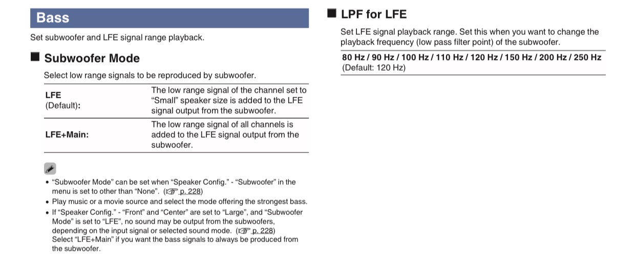

So, is there a setting that plays the LFE content on both the sub and mains set to large?? Is that LFE+Mains?
Sent from my SM-N975U using Tapatalk
Yes, check the note on the bottom of the page from the manual I just posted from Denon. This behavior is the same on Onkyos with speakers set to Full Band(Large) and “Double Bass” activated.
Trebdp83
Try it guys. Set speakers to Large and put it in stereo mode. Leave it at LFE. You should not get anything from subs. Play some 5.1 content. Should still be nothing from sub. Then, set it to LFE+Main. Subs should come on. Might be a bit different in some modes on Denons. But it works that way on Onkyo with “Double Bass.” Don’t make me dust off one of my Denons. :mad: Cuz’ I will, for science!;)

Yeah, I just got done playing with it. It's basically there (LFE + Mains) strictly for running your main speakers full range while still using a sub.
Which I wouldn't recommend unless you have true full range speakers and use a really low LPF. You lose bass management and some control over your fr that way.

Wait, so I had it right about stereo then.
Okay, so for stereo music. Does LFE + Mains or "Double Bass" mean that your main speakers receive a full range signal (bypassing the crossover) along with the subs playing bass redirected below the crossover at the same time? That's how I currently understand it. I think...
I was off about 5.1 tho.
Then for 5.1 content. Do the mains get a full range signal bypassing the crossover while the rest of the speakers remain high passed and the sub plays only LFE?

When doing the LFE&Mains thing I believe the set crossover still does some limiting rather than being bypassed....

Basically, if fronts are set to Large(Full Band), as well as center channel in a surround setup, LARGE(Full Band) speakers are sent the full signal inluding LFE, bypassing the crossover for those channels. Anything below the crossover point in, say Small surrounds, will be sent to the Large(Full Band) speakers, not the sub. Getting a signal to the subs would require LFE+Main(Double Bass on Onkyos) to be on. If all speakers are set to Small(40hz crossover or higher on Onkyos) then it is a non-issue as subs will get the LFE information AS WELL AS the bass from other channels based on their crossover.
I think the feature is a mess and needs fixing. LFE information in the LFE channel should always be sent to the sub regardless of the Large(Full Band) setting of the other speakers. But, it gets cut off and LFE+Main(Double Bass) has to be turned on for the sub to get a signal when the other speakers are set Large(Full Band.)

What if you just have real full range speakers and no subs?

Bass management is not universal or standardized as are the principles of it. In other words, you need to read your AVR/Pre-Pro Manual and then experiment.

Same thing. Except you would select NO to “subwoofer used” in the speaker configuration settings. Anything set to small would have it’s lower signal sent to the Large(Full Band) speakers and the LFE+Main(Double Bass) setting would be disabled. I’ve confirmed all of this with my Onkyo but not a Denon as I thought one of you all would do it and I wouldn’t have to tear my setup apart, again.:D I’m sure there are variations between all manufacturers.
