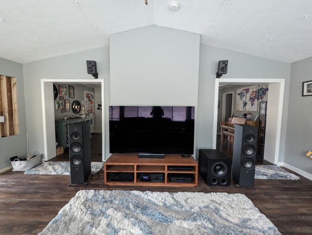

If you’re in SE Michigan and want to listen to 9.3.6 with wides PM me.
Hmm, I’ve been early adopter of front wides since , well 2012 and my Denon 4520CI then.
I remember all the conversations then with Audyssey Chris K
Specifically DSX
Testing location and their subjective results
Redoing side walls to minimize their intrusion into HT space.
RH side and LH side are symmetrical distance wise / angle wise. But construction wise LH is outside wall, engineered concrete, so I made an insert shelf and fit that. RH side is studded wall, 2 x 6 plate with 2 x 4 staggered for sound isolation, so built a shelf into the wall within those constraints as well.
End result this, modified the 2 acoustic panels also
Tidbit fact: this is the only known movie released in DTS:NeoX that actually used front heights / wides, as discrete full bandwidth channels also.
Not object speakers like today’s implementation.
In 2018 with my 8500H I then went 7.2.6 or 9.2.4.. and due to lack of wide mix usage and DSU not upmixing to wides I used 7.2.6 90% of time. However DSU was updated to then upmix to wides , as known.
Now with my A1H I’m full 9.3.6 always, and just a few days back rewatching this showcased a great Atmos mix that fully used wides, very enveloping
