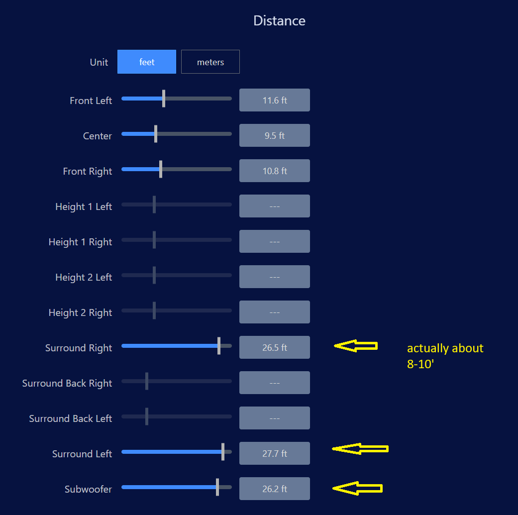

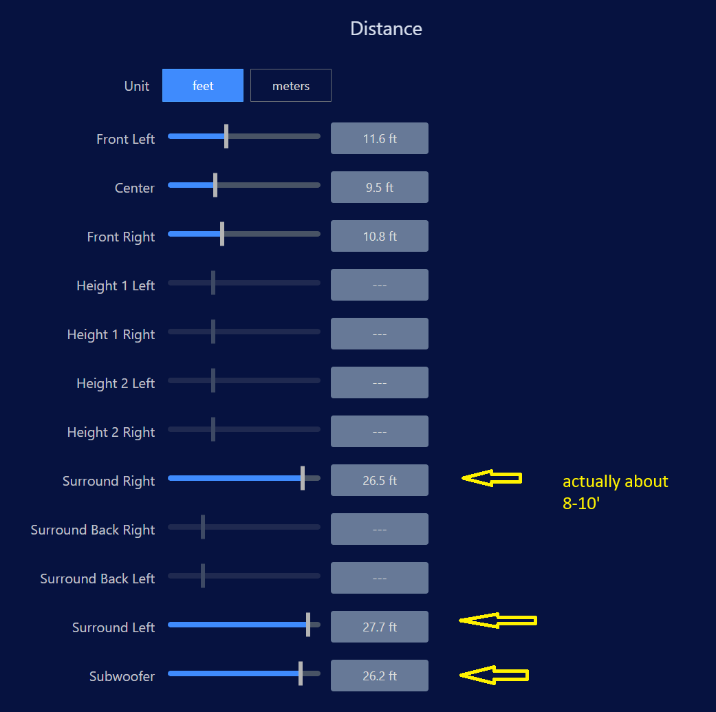

Just to drag this topic kicking and screaming back to the original point, the RF speaker connection.
With the new AVR I get a better report on delay-distance for them, and it's adding about 20'. That pushes it up near but not to the apparent limit of what it can correct, so in a large room with say 20' actual distance, it would exceed the correct-ability.
But these are well within it, and with the pre-outs now on the new AVR hopefully are not being impacted significantly by going over RF.

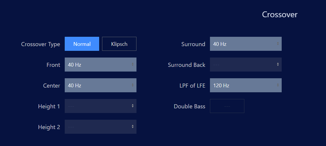

What are you crossing the surrounds at? Also what do you have the mains and center set at, crossover and speaker size?

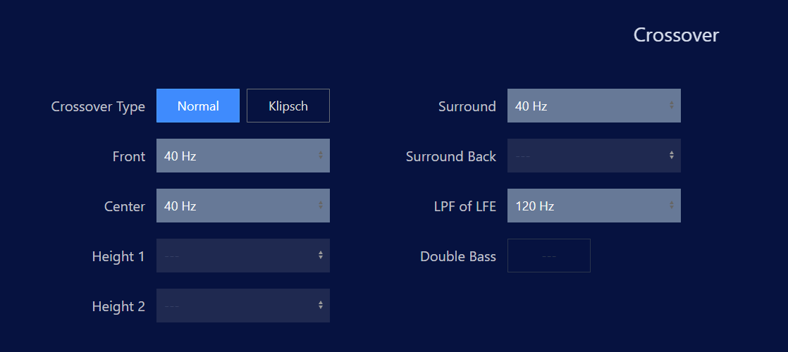

I haven't gotten that far to understand, but more importantly I haven't finished moving furniture nor tried the Dirac Live, which I think resets all that anyway?
But here's what it shows now (perhaps from the AccuEQ run). A really odd part of this is that during that run, the Sub had the AC power unplugged, so I have no idea what it measured.
Thanks. Once you get your room setup you're gonna need to make adjustments to the crossovers and likely speaker sizes but no reason to mess with it now until your finished. BTW, and I may have missed it, what subwoofer are you using?
