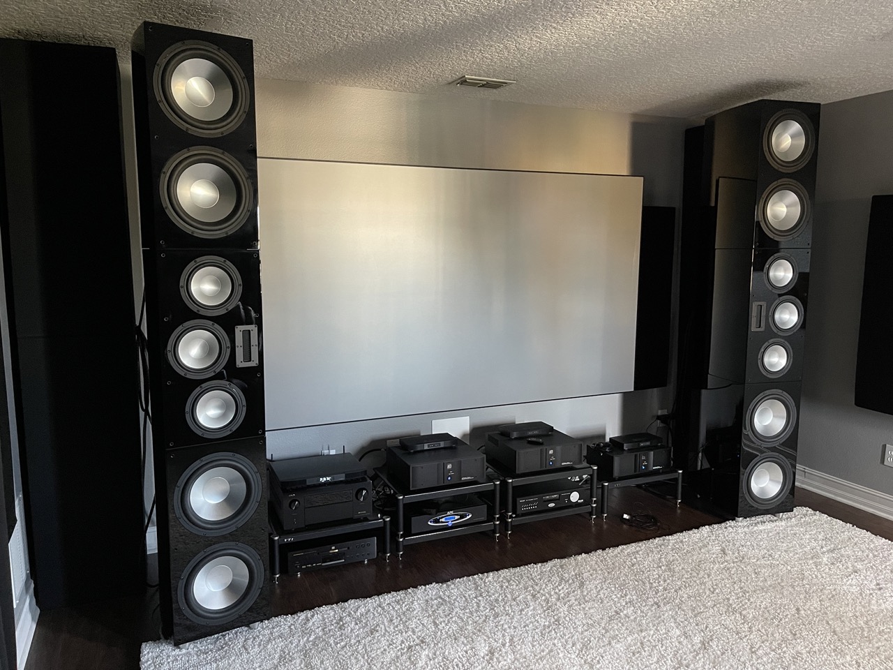

Now let’s talk about adding on to the last system you will ever need to buy - maybe later down the road. :D
1. Bigger Room
2. Bigger PJ Screen
3. High-power, High-Lumen, Professional Laser Epson PJ
4. Electronics? Most guys would be ecstatic owning the bada$$ Denon X8500. But….
I started my “Last System” thread after I had sold off my Linkwitz Orions, Revel Salon2, B&W 802D2, KEF Reference, Philharmonic 3, etc., and got my RBH Towers of power (SX-T2R).
I still have the same RBH SX-T2s. But the electronics have changed over time and the PJ’s have changed over time. :D

Electronics..... you already know what I think....but definitely for now I'll be staying put. How long though, who knows.;) Going to start working on the bigger room and remodel of the house. I know ATI is taking it's sweet time with the processor so I'm good for now... :).The rest will wait for the new room...
