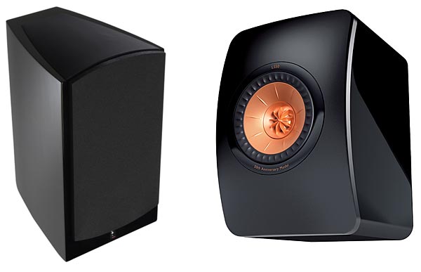

latest stereophiles has John Atkinson comparing Revel M106 vs. LS50. Interesting read as measurements somewhat comparable but different sound...worth a read.
Thanks, Randy, that'll be really interesting to read! I didn't see it on the review page - is it print only?
Sorry for late reply. Print only for now although I think at some point ends up on web.
This has probably been available online for a while now, but I figured I'd link it:
This is an interesting read and of special note, JA contrasts the differences between his Anechoic measurements and in-room measurements to reveal how much difference there was in how these speakers (which had largely similar anechoic measurements) interacted with the room! (they were, of course, placed in the same position).

A couple notes about that article. The article is an attempt to rebut the statement: "
The [1990s] were probably the last real decade that we could reasonably bend the truth. Everything since is verifiable electronically."
But the problem is he then attempts to rebut it using personal subjective experience, i.e., non-scientific, unreliable data. Something else to consider is that the Revel speakers have a wider dispersion than the LS50s, and that simply toeing them in more or less would have reduced the treble which seemed to trouble him, but without affecting the linearity of lower frequency ranges. Compare the off-axis responses of each speaker and you can see that a warm to neutral sound can be had from either speaker- depending on the angle you listen to them.
KEW
KEW
I would have to respectfully disagree with your interpretation!
As I read it, the crux of this article is the comparison of the traditional anechoic FR measurements vs the in-room FR measurements. It is more of a snapshot than a study since it is a sample of two speakers in one room, but it does show how the similar anechoic measurements translate to in-room measurements which show more obvious differences, thus showing that the conventional anechoic FR measurement does not give a very complete understanding of what you might experience in your room.
However, to your thesis that it is subjective, I think part of his investigation was whether the differences shown in the in-room measurement were relevant (audible) which requires subjective evaluation.
I appreciate your experience and comments on the effect of toe-in; however, when you say:
, I believe you are looking at the anechoic response for your comment about obtaining a warm or neutral response, while JA points out that he is in a small room with lively acoustics. Your point likely still has merit, but not so much as you might infer from the anechoic measurements.
I know I was shocked and intrigued by how the bass response was fairly similar between the speakers with close roll-off points, but in-room, the Revel (with anechoic roll-off around 51Hz) actually goes back up to -1dB at around 33Hz. Looking back at it a delta of ~6-7 dB is maintained in both measurements, but looking at the anechoic chart I would not expect that to be very audible...however, looking at the in-room response, I would expect that to be a very significant aspect distinguishing one speaker from the other!
I am not so well versed as you (or JA) for correlating measured differences to perceived audible differences, but the in-room chart adds a lot of information (if it was for my room) that is missing from the anechoic chart!
