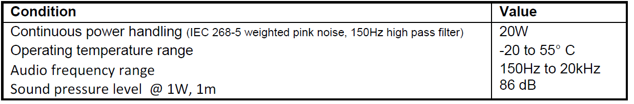

You can reference the driver's specs that should give you some ideas.
Woofer:
Power Handling 100h RMS noise test (IEC 17.1) 100 W Long-term max power (IEC 17.3) 120 W
BMR mid range driver:
RAAL tweeter:
I don't have power specs for the tweeter, maybe Dennis has?
The Crossover would of course absorb some of the power (loss).

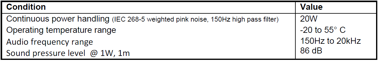

Woofer:
RAAL tweeter:
The factory specs are hard to interpret. For example, I'm sure that BMR driver rating is for full-range application, whereas both ends of the response are steeply rolled off on the BMR in my speakers.

Power handling can't be described by a single number for a speaker, or even for a driver within a speaker, because it has frequency and duration components.
As Dennis points out, that BMR driver can probably handle well over 20 Watts in the range in which its used in the BMR Philharmonitor. But at, say, 50 Hz, I doubt it can handle even the 20 Watts listed.
And then there's the issue of time. How long is the power sent to the driver? Milliseconds? Seconds? Minutes? A driver might handle a signal for a brief instant with no repercussions, but play that signal for several seconds and the heat build up might fry the driver.
I meant the driver's specs would give us an idea, that's all, assuming they are used with competently designed crossover and enclosure. That 20 watt spec was based on using the specified noise with a 150 Hz HPF, so you are right, no 50 Hz..
I have no idea what the underlying assumptions are. I think it comes down more to the excursion limits of the woofer.
PENG
For that BMR driver, aside from what they stated in the table, such as the specified IEC-268-5 noise signal, with a 150 Hz high pass filter, I am just guessing that the manufacturers would have assumed their products are used with properly designed crossovers and enclosure so that the audio signal will be within their specified frequency range, and used in room temperature. I am sure you designed the XO point for that driver well above 150 Hz.:)
