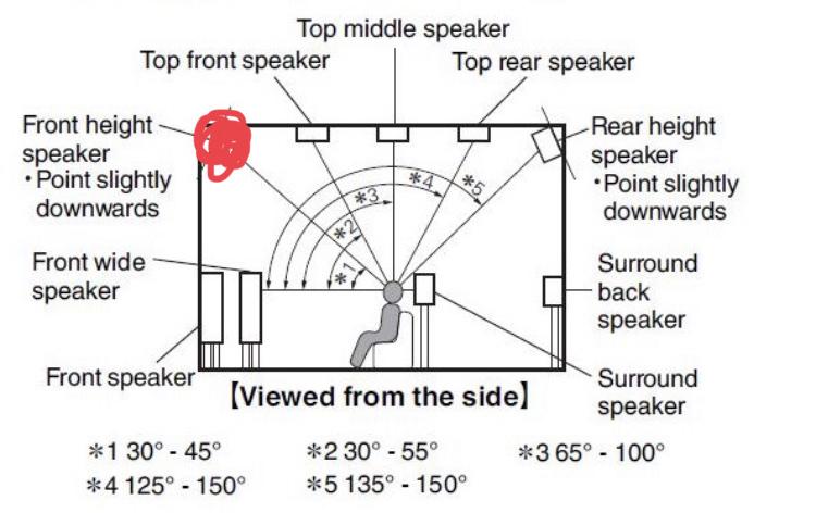

For spacing, with the lower ceiling especially you’ll want to keep the speakers as much in a square above you as you can. Like this...
45° in front and behind.

So as long as you have room fore and aft of the LP on the ceiling I’d go in ceiling over heights. The diagram is referencing in ceiling.
Ignore the red blob. This is just to show the supported locations. If you measure from seated ear height to the ceiling, that’s the distance you’d mount the IC speakers forward and rearward. So if it’s 4’ above, then 4’ in front of and behind will give you the 45°.
