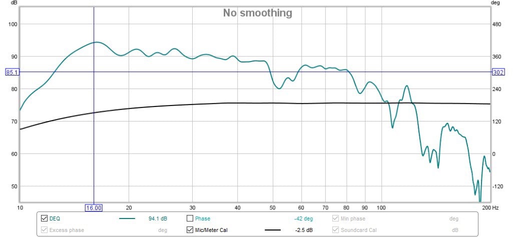

You’ll want to use peak filters(if I remember that right. Been awhile lol). The shelf is where you want the high pass to start. For example, a shelf filter at 20hz with a +5db rise should give you a house curve that starts at 20 and slowly slopes down to about 200hz. Below 20, you can set the slope(I think) of the roll off to protect the subs if they’re ported for example.
In the image below you can see that the curve slopes from about 16hz@95db to 80hz @ about 85db.(this was without mains) that’s basically a house curve, and the “knee” is where the line starts to bend at 16hz. People sometimes say they put the “knee” at xyz frequency meaning where the shelf is.

Good information. Thanks again for the lesson! I think I will try moving the subs around one at a time to try and get rid of those nulls.
