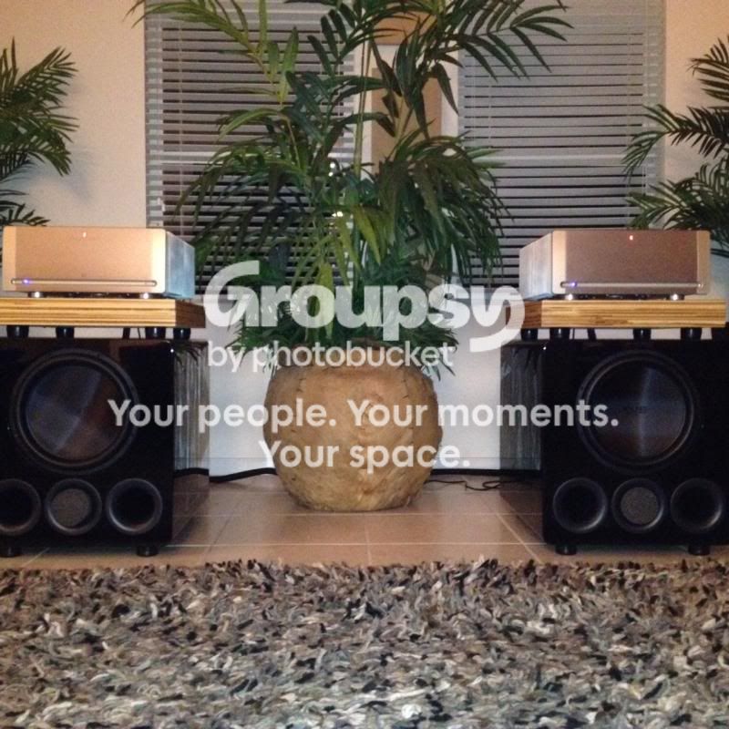

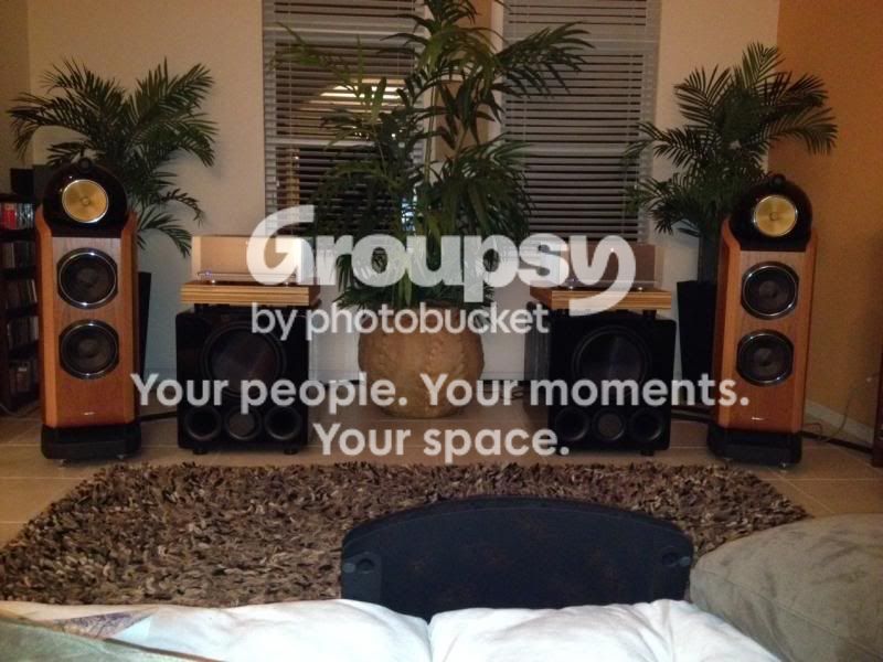

I have a pair of SVS PB13's in my system and I couldn't be happier. My system has never EVER sounded so great! Whomever is considering SVS for music only, I can't give SVS a higher recommendation. I think I have it dialed in @ 99%, tuned to 20hz, I'm using an outboard crossover with 24 bd per octave slopes and have settled on 80hz - sounds pretty amazing to me. When a song has the bottom end on it, the system rocks the house (literally). They are enormous though, but I doubt you can get this much output unless you have big boxes. Here's a pic of the subs with Parasound JC1's on them so you get a sense of how big these guys are.
