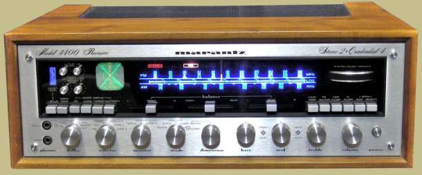

A friend reading my post sent me an email, and he says he would definitely buy a "new" classic Marantz receiver. Similar brushed golden aluminum, blue lights, weighted horizontal tuning knob - though he wants one with a scope too. Update the amp section for more power. Make the wooden case an every unit item. I asked if he'd pay $4K for that and he didn't say "no".
(If you're reading this, Sam, I think you have more money than sense, but who am I to talk?)
So Sam wants one of these.
The receivers with the scopes were quadraphonic, so the scope had a purpose if you knew what you were doing.
In stereo there were 125 watts per channel both channels driven.
What Sam wants to do to one is vandalism. By all means restore it to original specs, but don't add bigger amps which will mean a new power supply. This is akin to the vandalism perpetrated by far too many Americans to vintage autos. They change the suspension, wheels and put in souped up V8 engines with modified headers and Edelbrock carbs.
In the UK vintage cars are restored as far as is possible and kept as close to historical records as possible. Many are raced and rallied hard.
There are serious collectors and restorers and then there are vandals. Tell Sam not to be vandal or keep his hands to himself.

I think you misunderstood, Mark. Sam wants the Marantz equivalent of the JBL speakers that Gene posted about in this thread. Sam doesn't want an old Marantz receiver, he wants a *new* Marantz receiver that just looks and feels like an old one!
I got the speaker part, but I thought he wanted to soup up a vintage item.
I still don't see the point of either bogus old speakers or receiver. Both will lack the venerability of age and I don't see the pleasure or point of it. Much better to look for, and restore the genuine article. That is the real pleasure.
Bogus vintage has never held any attraction for me in any guise.
Irvrobinson
Irvrobinson
You and I are dinosaurs, Mark, if we want nostalgia we want authenticity. A lot of folks these days just want the look and feel, but new technology under the surface. I understand it. I don't want it myself, but I understand it.

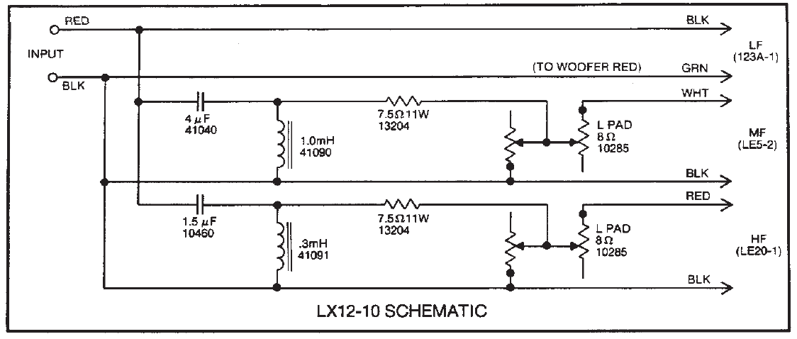

During the 1970s, JBL had four different models that use the same or similar drivers and cabinet. From left to right in the photo (in reverse order of their introduction) are the 4311, L100A Century, L100 Century, and 4310.
The oldest design is on the right, and each newer version appears to it's left. The 4310 and 4311 were the pro studio monitors, and the L100 Century and L100A Century were the commercially sold versions. They all shared the same or similar versions of 123A woofers and LE5-2 mid-range drivers, but had different tweeters, the LE20 in the 4310 and L100 Century, and the LE25 in the L100A Century and 4311.
The L100 Century had the vertical alignment of drivers, and had a crossover network of sorts:

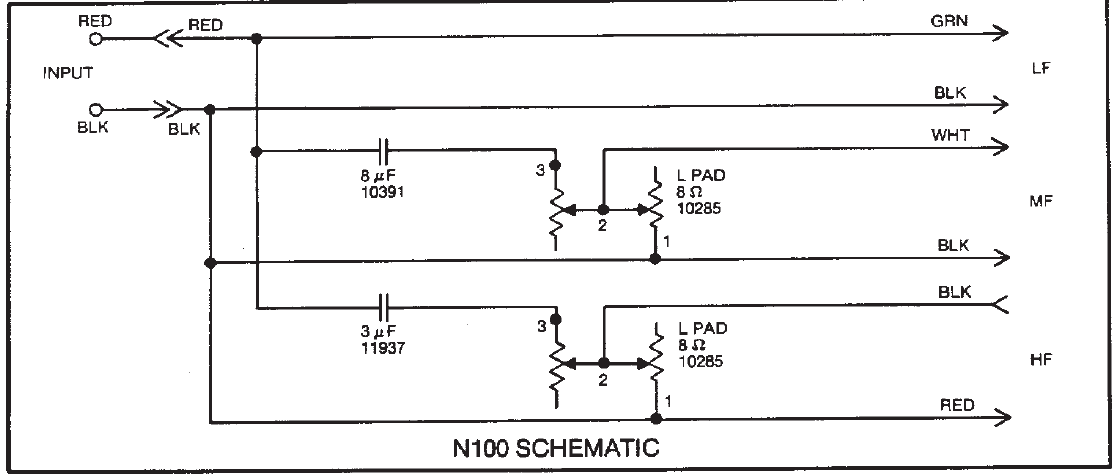

My speakers that Dennis used to design his new crossovers were the L100A Century. They had a much simpler network:
There was a 3rd version, also called L100A Century, later during the 70s. Apparently it's drivers were somewhat different than the earlier L100A, but the driver layout and crossover were the same. (I forgot that until I read eargiant's post showing his very nicely restored cabinets.)
I hope I got all this right and explained it clearly.
And finally, Dennis's new crossover for my L100A speakers is fully described here https://forums.audioholics.com/forums/threads/the-vintage-jbl-west-coast-sound-becomes-the….25014/.

Thanks Swerd. That clears it up. It's strange that they would have abandoned the in-line driver configuration for the more helter skelter arrangement that introduced all kinds of interference effects between the drivers, which was exacerbated by the fairly shallow crossover slopes. The professional studio monitor looks even worse. Kind of scary that they were so popular in recording studios.
