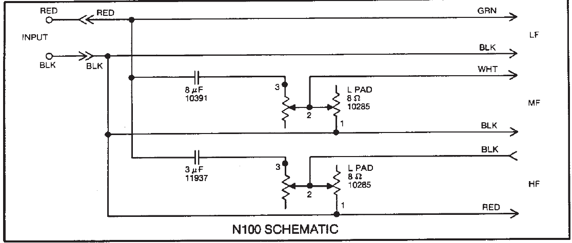

Here is Dennis's frequency response curve of the L100A with it's original crossover (the speaker sat vertically for this):
And here is the same speaker with Dennis's crossover (again, the speaker was vertical):
Old crossover schematic (Note there is an error in my drawing, the midrange driver should show opposite polarity to what appears.)
And Dennis's new crossover schematic (all driver polarities are shown correctly):

During the 1970s, JBL had four different models that use the same or similar drivers and cabinet. From left to right in the photo (in reverse order of their introduction) are the 4311, L100A Century, L100 Century, and 4310.
The oldest design is on the right, and each newer version appears to it's left. The 4310 and 4311 were the pro studio monitors, and the L100 Century and L100A Century were the commercially sold versions. They all shared the same or similar versions of 123A woofers and LE5-2 mid-range drivers, but had different tweeters, the LE20 in the 4310 and L100 Century, and the LE25 in the L100A Century and 4311.
The L100 Century had the vertical alignment of drivers, and had a crossover network of sorts:
My speakers that Dennis used to design his new crossovers were the L100A Century. They had a much simpler network:
