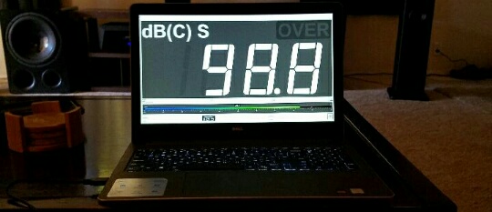

Well... -5 on my dial is getting into earbleed levels, but I'm all dialed in for "reference" at 0 with Audyssey. That's really loud for movies, and very very loud for some music. An spl meter would tell us a little more. If you have a smart phone you can find one in whatever market or app store you use for free. They're not the most accurate thing you can use but can get you in the ballpark. That's give us a better idea of the volumes you're hitting.
Just going by the video, I know that by the time my 5 1/2" drivers are moving as much as yours with a 80 hz crossover it's really loud. Are you using a subwoofer right now? How did you set the crossover? It could be too, that your amp is clipping.

No there's no sub, but it's on in the setup config, the crossover is set to 100, and for reference, -10db on the levels noise test, shows as 72db

You might be right. I'm still curious to see how loud it really is when you have it cranked up to reference with an actual spl reading tho. Do you have a smart phone you could get a spl app with? Or do you have a meter already?

With the right music I can hit almost 100 dB peaks at my seat with my volume at 0, and I sit 15' (about 4.5 meters) from my speakers.

Yes, that's stereo. It gets pretty fracking loud with movies too tho. Reference for movies is 85 dB, with room for 105 db peaks. Depending on how far you sit (did you say 9 or 10 feet?) that can be a lot to ask from your amp.
PS, not ruling out an issue with the speaker either. You might be right. I'm just tryna figure out how loud it is where you hear the pop.

I'll check, and my front are around 3 metters from the sitting position
