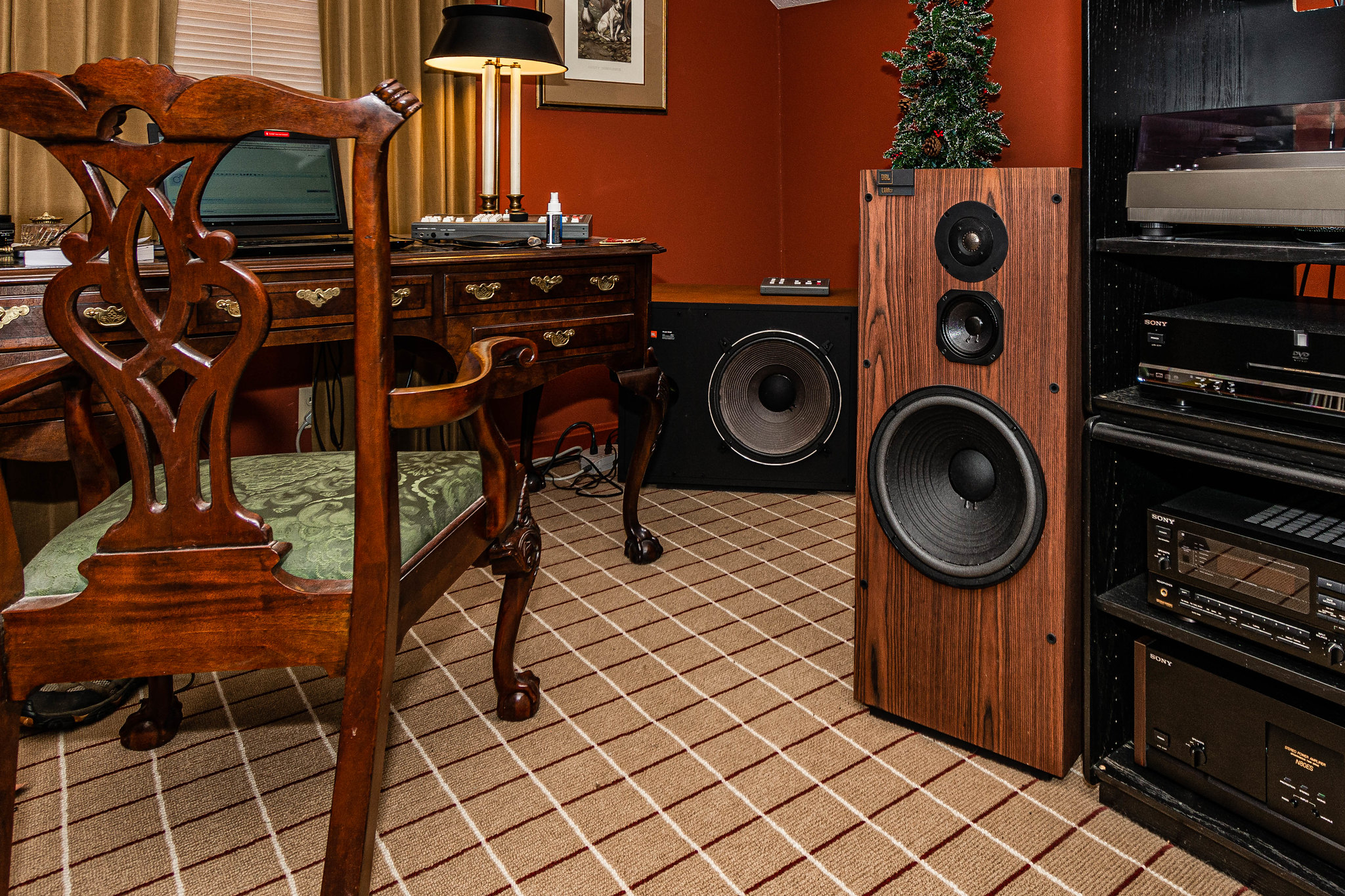

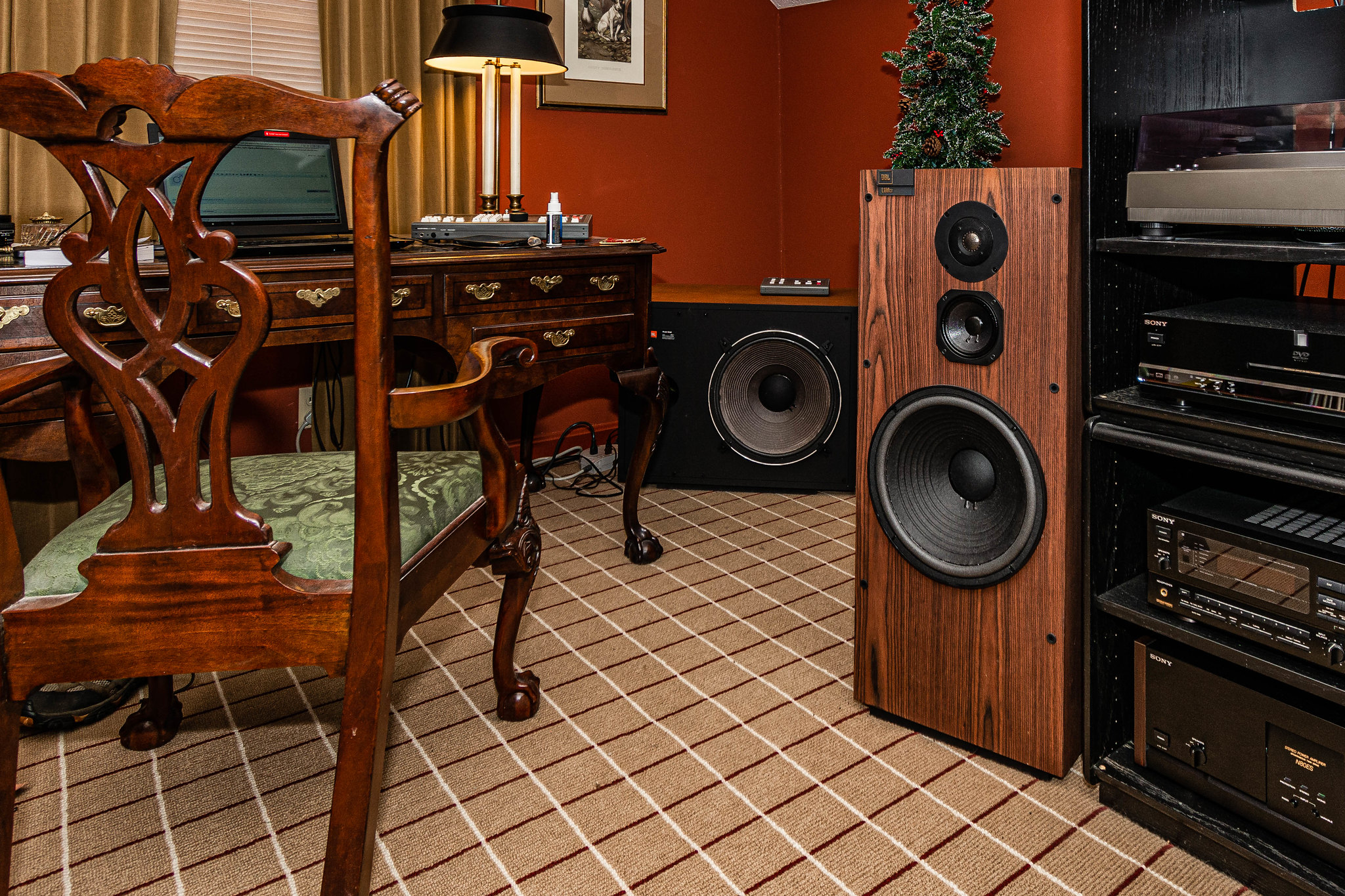

Here's my 15 inch JBL B380, a passive sub powered by a Sony TA-N80 amp bridged to mono for 560 watts. Thís sub serves two 2.1 systems and a 5.1 system. It gets into the 23 Hz arena at -6db. Paired to JBL L100t3 mains I get satisfying
low end performance from music which has low end content. If I removed this sub from my three systems, I would miss it.

Here's my 15 inch JBL B380, a passive sub powered by a Sony TA-N80 amp bridged to mono for 560 watts. Thís sub serves two 2.1 systems and a 5.1 system. It gets into the 23 Hz arena at -6db. Paired to JBL L100t3 mains I get satisfyingView attachment 56587 low end performance from music which has low end content. If I removed this sub from my three systems, I would miss it.
That is an very nice setup . I had a pair of l-100’s way back I’ve always wondered how the sub would work out I see them from time to time come up for sale .
