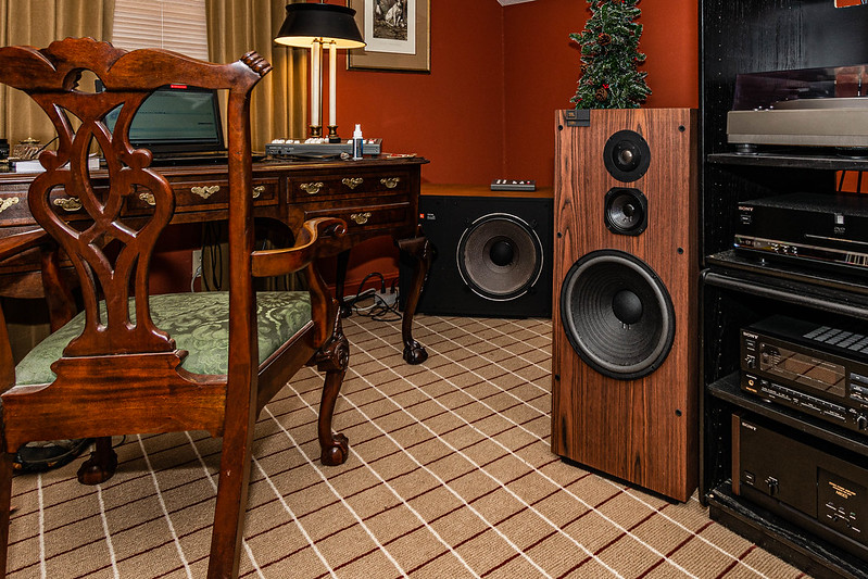

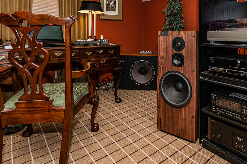

Playing the four great toccatas and fugues with low frequencies reproduced from my circa 1986 JBL B380 15 inch passive sub powered by a Sony TA-N80ES for 560 watts in bridged mode just gives me goosebumps. If I did not have it in my system I would buy one of the 18 inch subs in JBL's Cinema line, not the HDI model, which is just too small for effects I want.

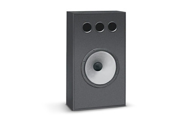

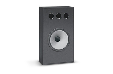

View attachment 50608View attachment 50609 Playing the four great toccatas and fugues with low frequencies reproduced from my circa 1986 JBL B380 15 inch passive sub powered by a Sony TA-N80ES for 560 watts in bridged mode just gives me goosebumps. If I did not have it in my system I would buy one of the 18 inch subs in JBL's Cinema line, not the HDI model, which is just too small for effects I want. View attachment 50610View attachment 50608
I would bet the JBL cinema subs aren't tuned at frequencies much lower than the HDI sub, to be honest. Few subs made for cinema would have a tuning point lower than 30Hz. The one that you have pictured is the 3536 which has a +/-3dB response window of 38Hz to 100Hz, so it is doubtlessly tuned to a higher frequency than the HDI sub. Not really the greatest for deep digging pipe organ music. The ideal sub for pipe organ would be one tuned to 16Hz since that addresses the fundamental frequency of a 32' stop which is the largest practical pipe length that an organ can have. Dr. Hsu is a fan of that content and always aimed for a 16Hz tuning point for this reason.
sterling shoote
yes, I just grabbed a shot of one of the models in the line but I’d still take it over the HDI model.
