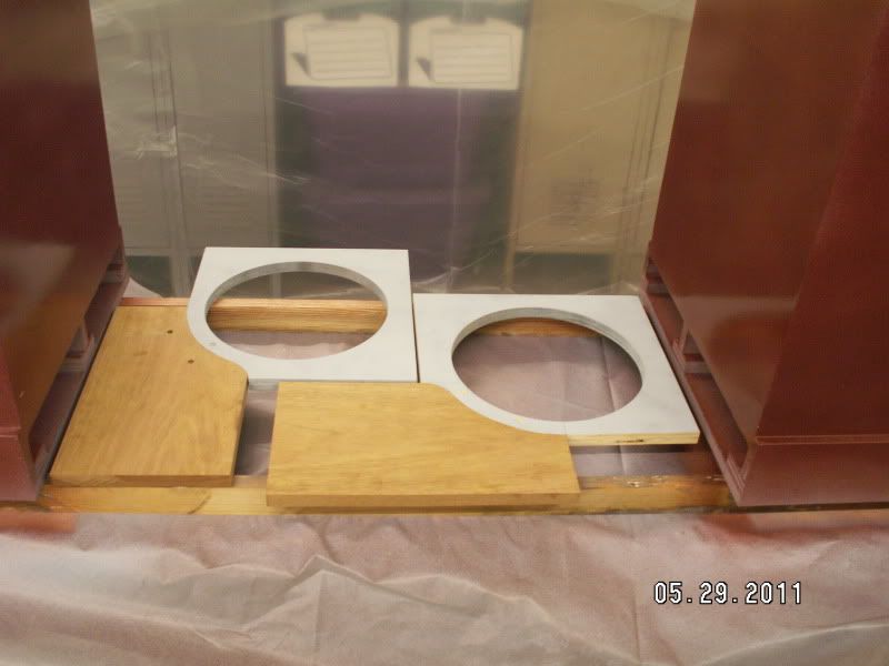

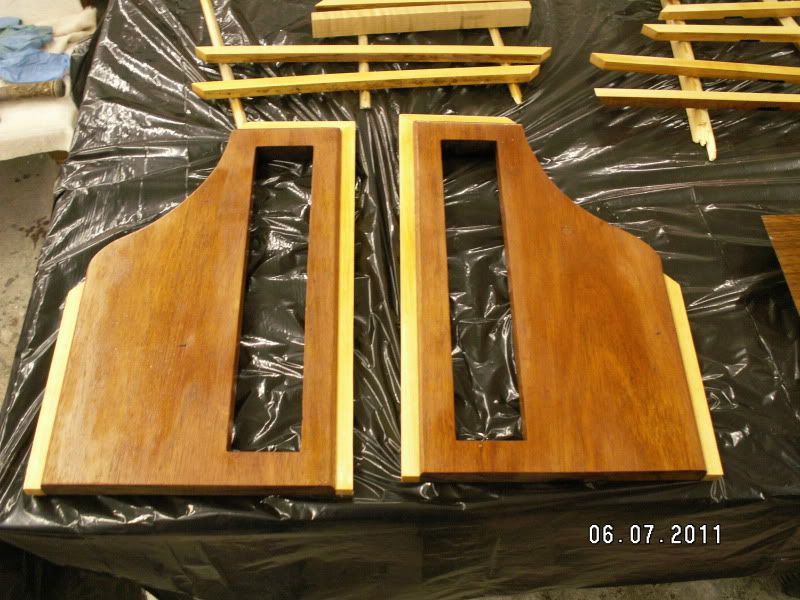

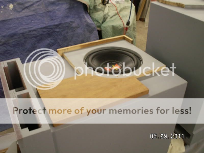

Today I made the faces. After the paint is finished and the drivers are in again I will cut the port mouth into the African Mahogany portion of the face.
The mitered piece you see on the corner is just a gauge. In it's place trimming out the entire perimeter will be some curly maple I am going to mill up.

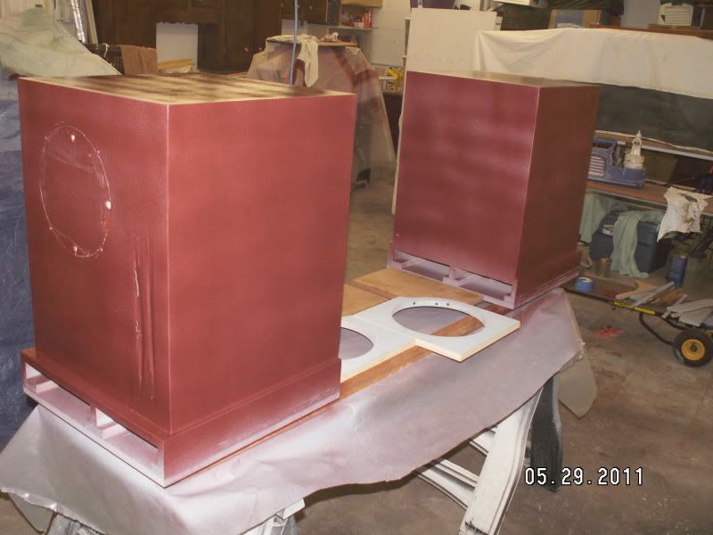

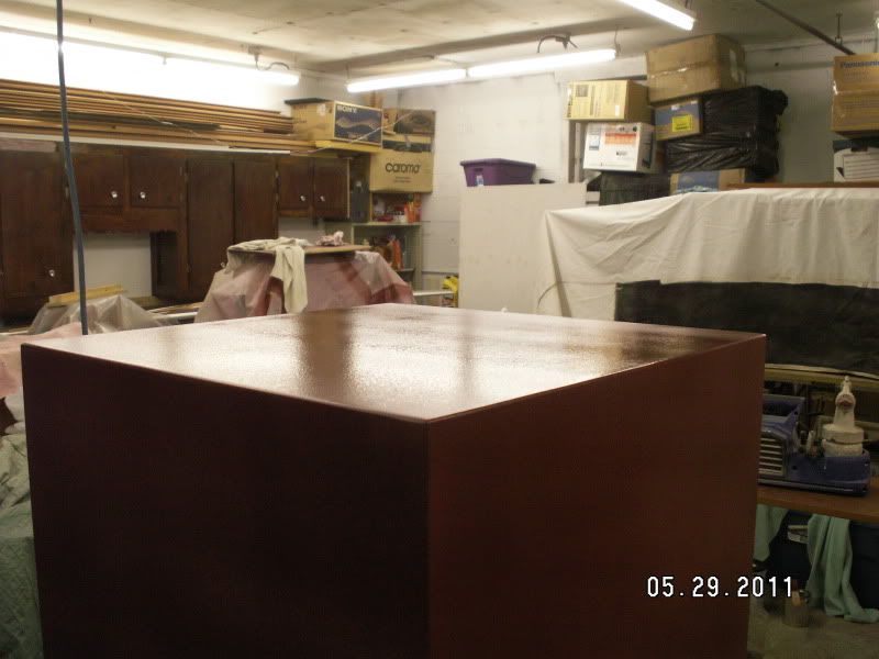

Here are some shots of the one coat of color ...
... and the top sans visible screw holes. The orange peel lays down as it drys and to lessen it on subsequent coats I can either thin it out a bit more or give it more air. This is the better of the two enclosures ... you didn't expect me to show you the worse of the two, did you?
Here's both faces so you don't think I only made one and I only put the differing multiple radii in there because I didn't want GO-NAD! to think I was taking the easy out.

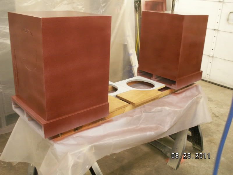

I had a couple of set backs with the paint. It turns out that the EZ Sand doesn't adhere too well as a skim coat, latex paint doesn't like being wet sanded and a second coat of paint will blister the first coat after the first coat has been wet sanded and probably some other sh!t went wrong like I didn't allow enough dry time in between whatever steps I was taking. The f^%&ing wheels came right off this pig. :eek: :rolleyes:
So ... after some sanding, digging and gouging I am back to having one coat of color on top of 3 coats of primer and two coats of regular brown bag Durabond which is suppose to stick better as a skim coat according to something I read online..
Also I added Floetrol to my primer and paint.

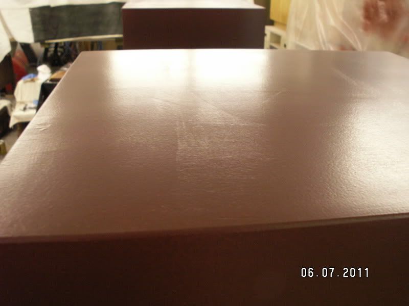

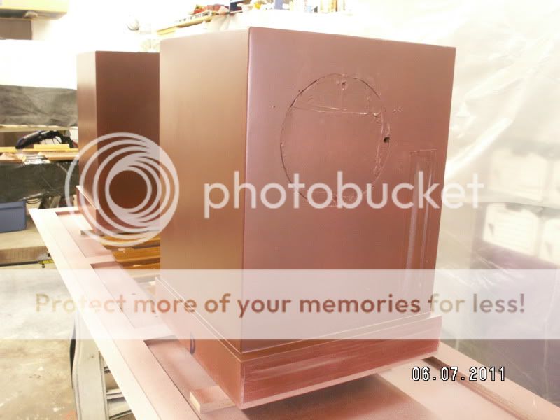

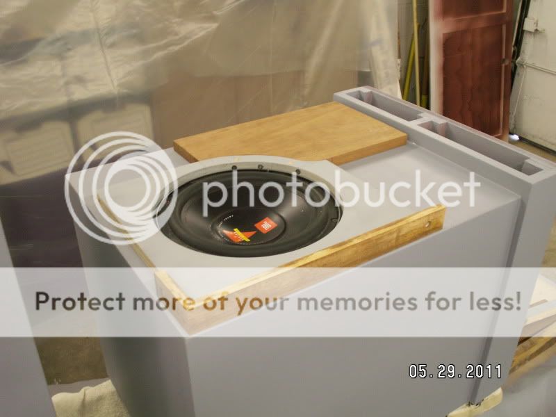

Okay, here's the worst of it. That little spot on the left pops up with a fresh
coat of paint but settles back down. That's 2 coats of color now. I'm gonna
stick to my guns and not sand for coat 3. We'll see where we're at then but
I'm gonna try to not sand.
Here's a more forgiving shot of the both of 'em.

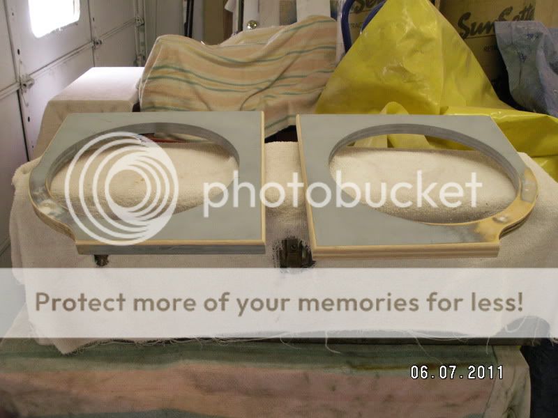

Here's the part of the faces that gets gloss black paint out of a spray can. I
have them primed black now and I have the grill framework cut and primed as
well. No pic's of that yet though.

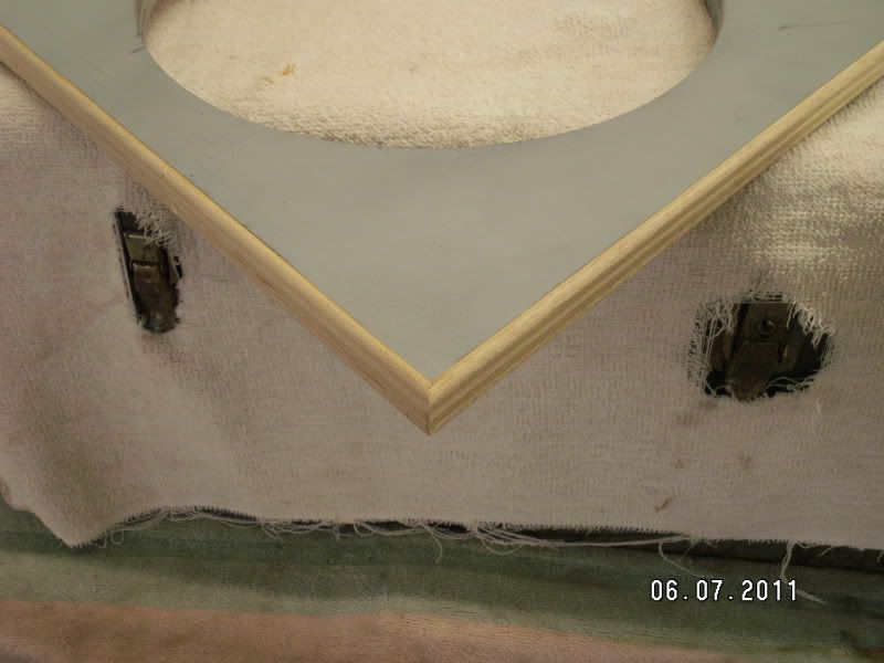

They got the router love.

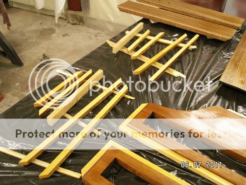

The ply end grain will get little 1/2"x1/2" maple trim pieces like the ones on
the Mahogany portion of the face with the cut out for the port mouth.

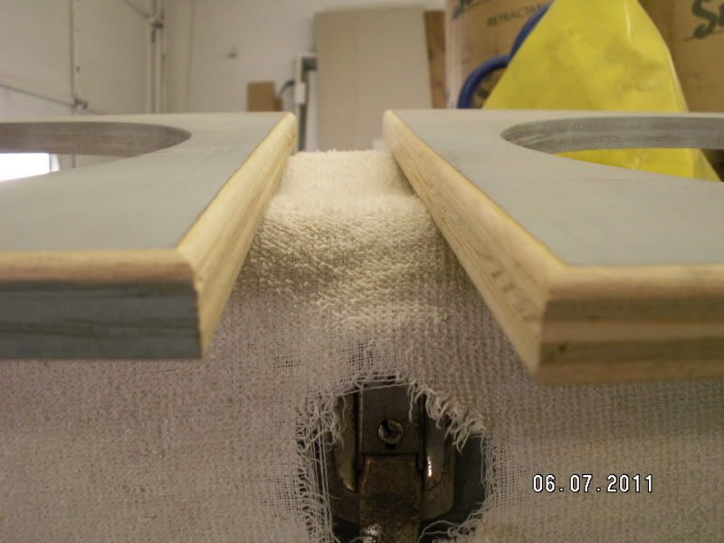

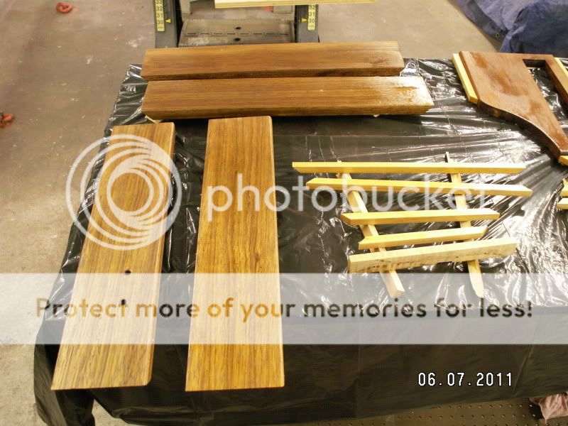

Here's the maple sticks along with the cladding for the base with the holes
for the binding posts in the piece that goes in the back.

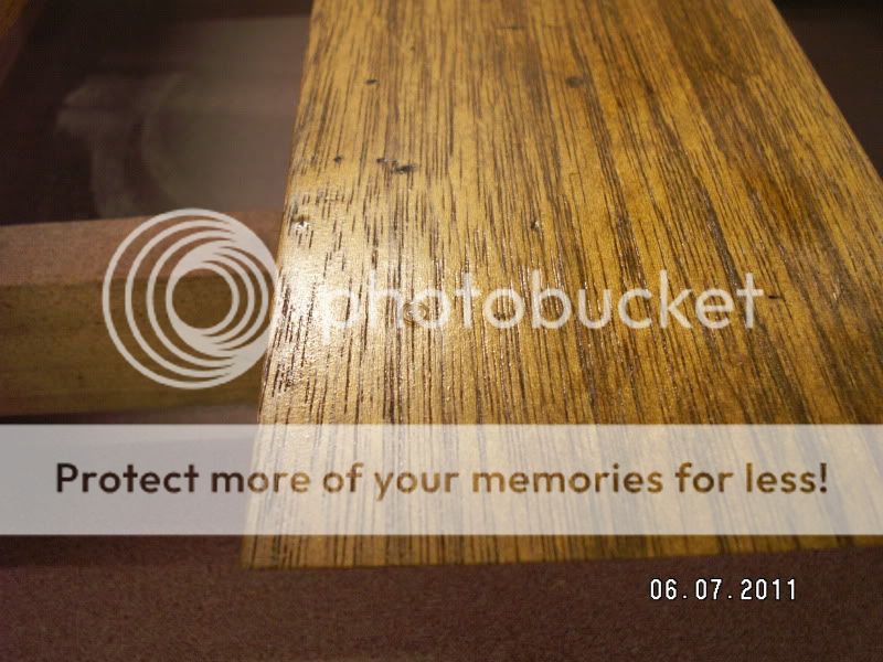

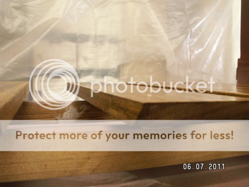

The Mahogany got one coat of satin polyurethane brushed on. I'm not going to spray that in the same room with the painted enclosures but the next coat of poly won't be out of a shaken can. I read the directions saying not to shake but to stir the poly after I shook it up real good causing the pretty bubbles.
Here's another pretty bubble.
I'm contemplating using grain filler to take the Mahogany to the next level
but hate the idea of dragging this out any further. Ugh ... I wish Eddie's shop
wasn't 40 miles away but I sure am glad he has a shop that he lets me use.
I just hate paint jobs. Even the smallest sin does not go unpunished!
I would paint the varnish with a good varnish brush. Use 7 or 8 coats and rub lightly with very fine wire wool between coats.

The paint being a semi gloss shows the flaws quite readily but the lighting condition in my room are much dimmer than the shop. I can accept less than perfect on this first build. The next time I go at this I would like to drop the enclosure off at a shop my brother in law has used to refinish stuff.

Polyurethane wants to be sanded with nothing finer than 220 grit paper to allow for a tooth that the next coat can mechanically bind to. A mineral spirits wipe and tack cloth dust removal is in order after sanding. With shellac you can go super smooth as the alcohol reactivates the dry coat and the new coat melds with the old one. This is something that I've read up on in the past and I've tried my hand at refinishing a few pieces. There still is plenty for me to learn about various finishes however I like to stick with poly and I sort of know what to expect from it.
I have got on much better with a 0000 wire wool than fine sandpaper when using varnish. The next coat seems to adhere much better. A light hand rub works well, I have found. The varnish must be dry, or you will get bits of wool on the surface. I use Prep All between coats.

I re-read what my book had to say about brushing varnish and it supports what you're saying.
The product I am using is a Fast Dry Min Wax.
I used the 'Floor' formula on a few things before and seem to remember them saying 220 grit but to be honest I haven't read this can's instructions.
It sounds like you're using the wax remover/degreaser the same way I am using mineral spirits. I wonder what's in the Prep All ... just looked it up, toluene. Interesting stuff. I don't have any experience with it but it looks like it might evaporate more quickly than mineral spirits. You're just using it to remove dust, right?

Yes, it removes the dust and dries right away. It does remove any grease that might have come from your hands.
The varnish you are using is fine.

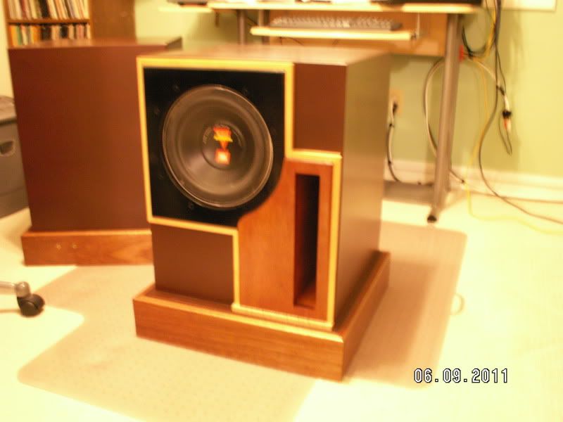

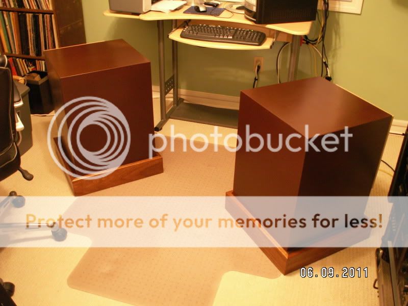

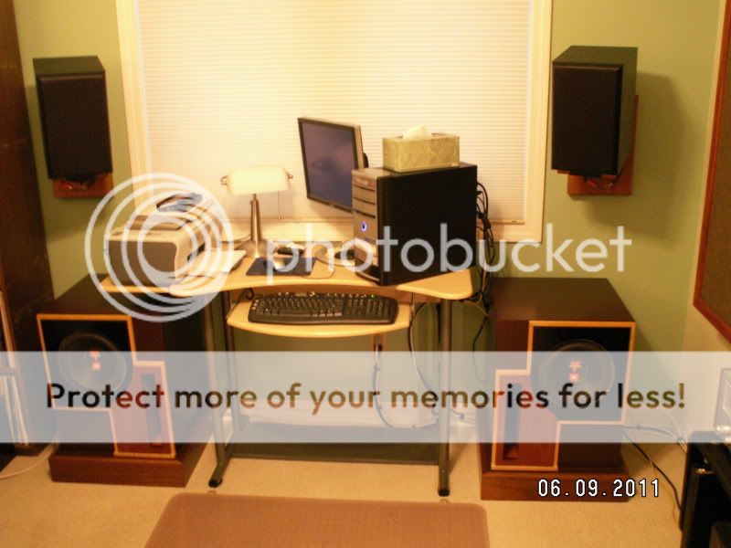

Now on to the real deal ...

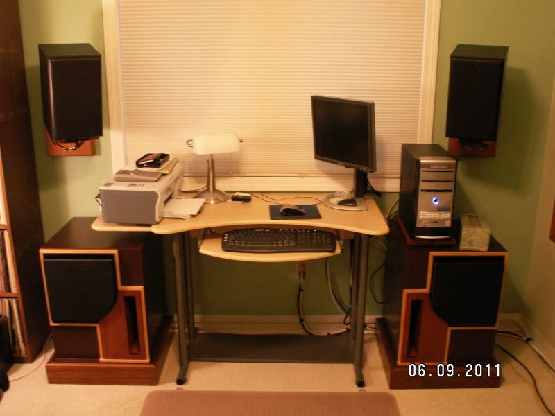

They weigh 105 lbs a piece. I haven't hooked them up yet but they already sound good. :)
