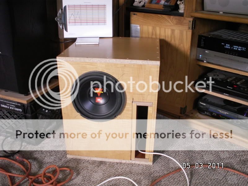

I wonder if my sub project would integrate well with this speaker.

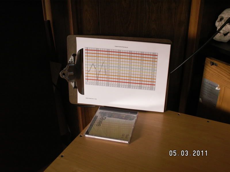

I tested both drivers and got identical response graphs from a tripod mounted meter on Eddie's coffee table. Nice hole at 50Hz but that's the room. Even Eddie's sub has a mean dip there.
I still need to make a base of sorts for this and a face.
These things weren't exactly light but they're gonna get heavier.
I cranked some tunes through them and vibrated the clip board off.
That tells me bracing is an absolute necessity.
Now I can proceed with both enclosures knowing the drivers are fine. I think I'm gonna like these.

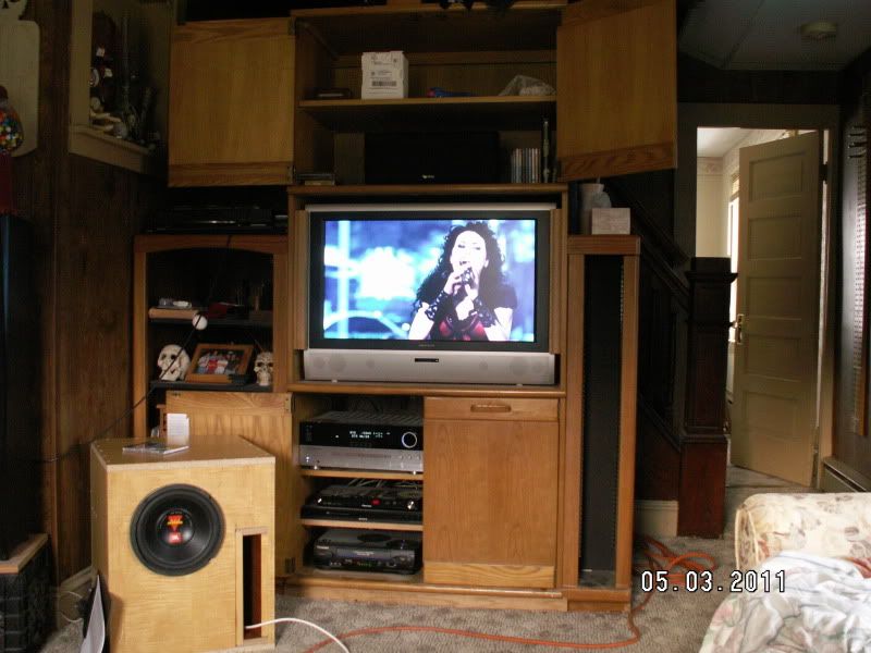

hmmm! who is that on the TV screen?
I was trying for a shot of the bass player for Doug but she was on the screen a lot. From the CD the tune Sinead or whatever, track 8, is absolutely killer. I've been blaring bits and pieces of the DVD at Eddie's cause I can't do that at home ... well, not in good conscience anyway.

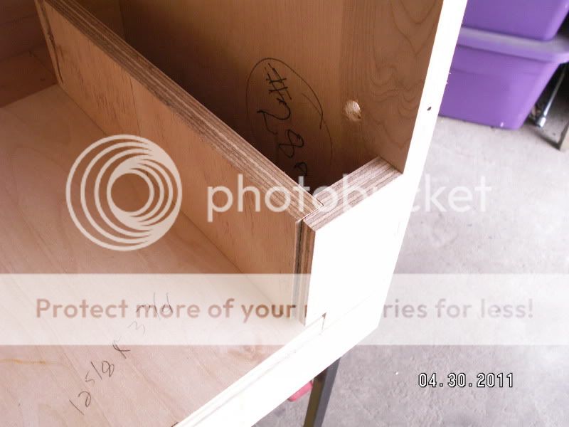

I did finally seal the unfinished wood on the inside of the box.
We went from this ...
to this ... :D
Eddie stayed on the other side of the shop once I broke out the pink paint. :confused:
Sharon den Adel ...
