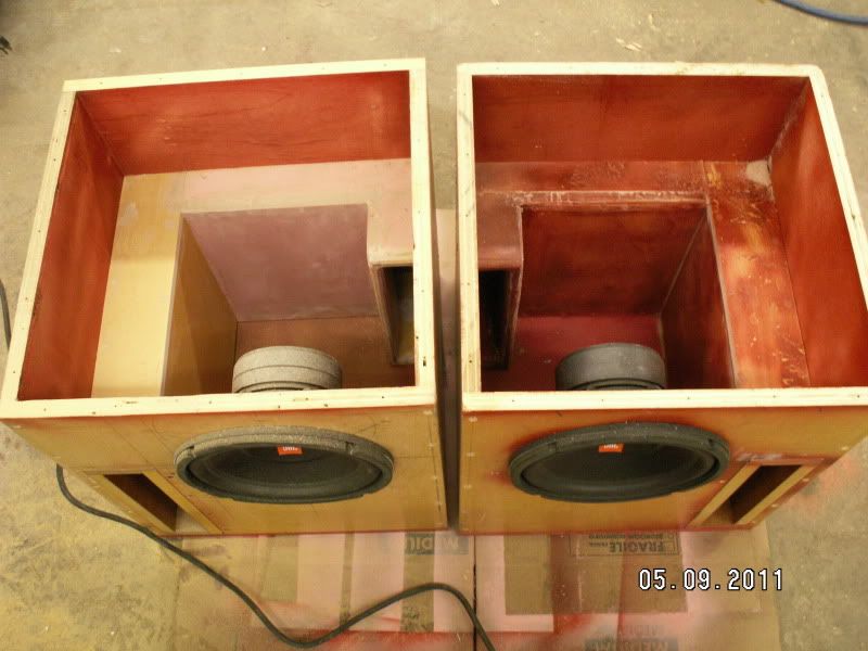

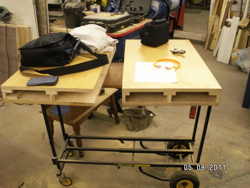

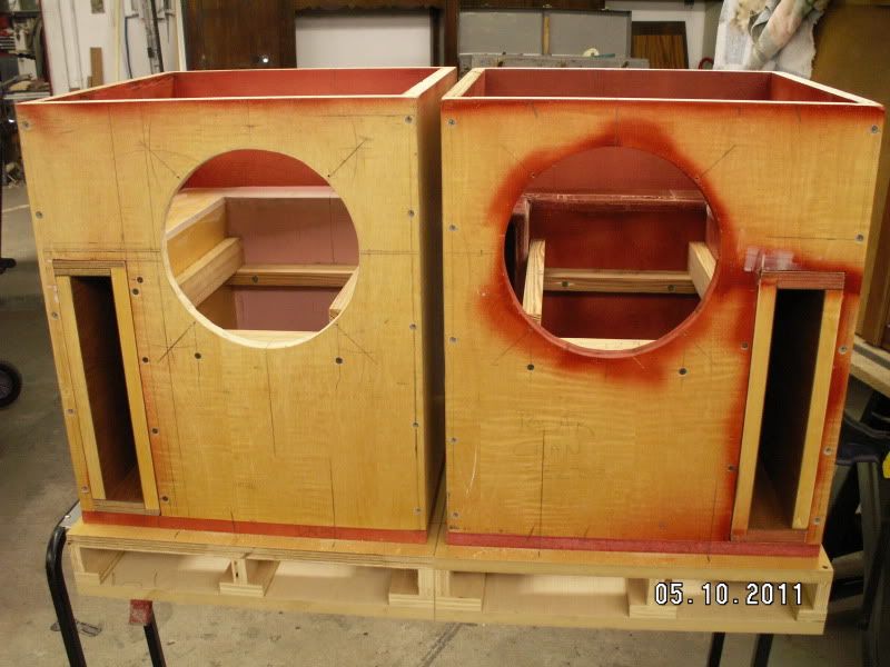

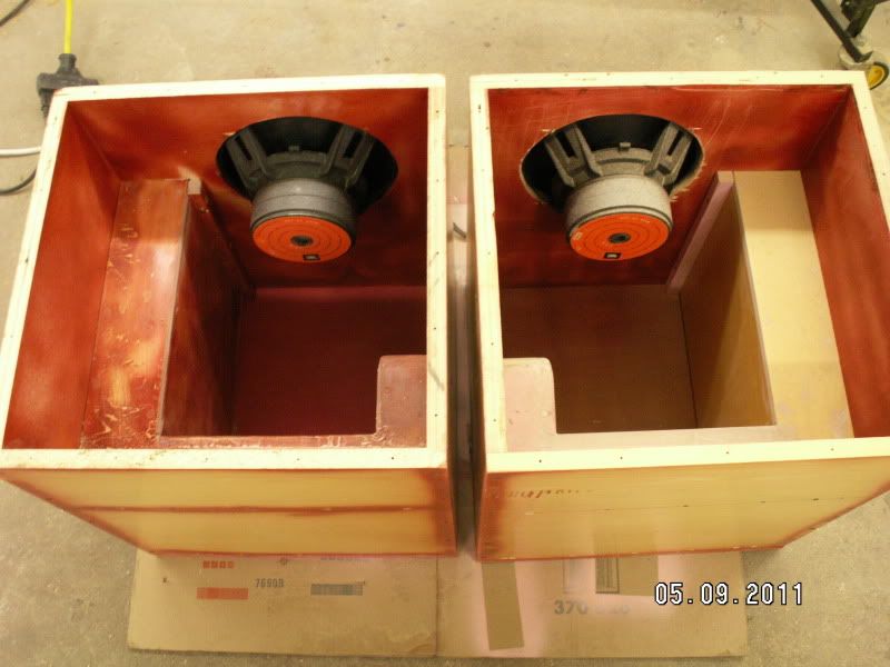

Here's some pic's.
This is what I'm going to use for bases.
Whatever volume I have in the bases is what I can use for braces.
The base further adds to the complexity of the build but that's the price of free lumber. On the bright side it will get me a look I am after. Instead of it being like a toe kick on kitchen cabinets these bases will protrude 3/4" from each side.
I think I'm thinking about painting the whole thing.
I think I'm thinking about painting them ... green? ... yeah, green ... :eek: :D

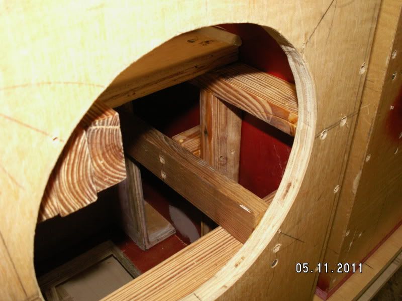

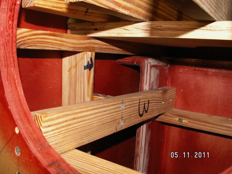

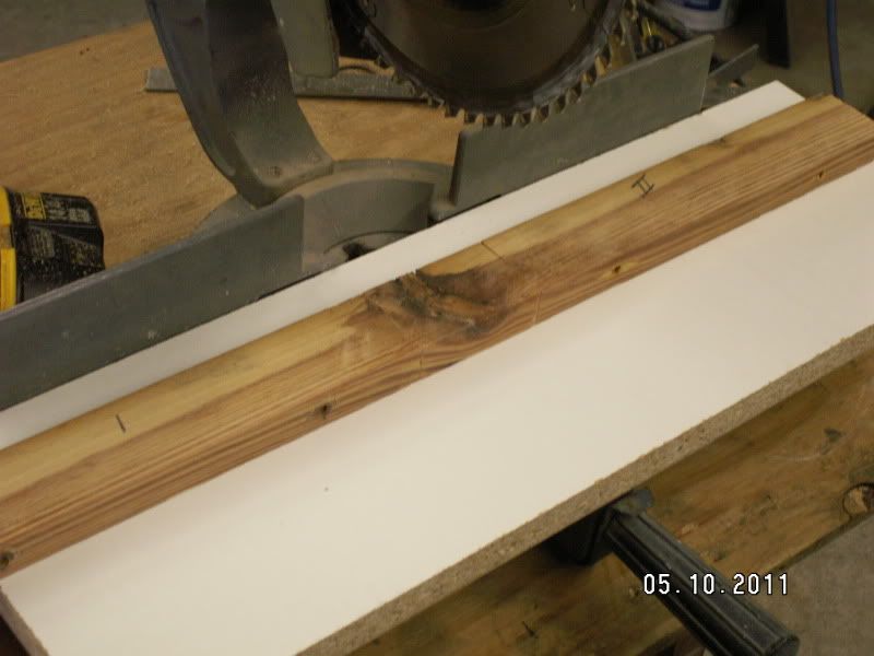

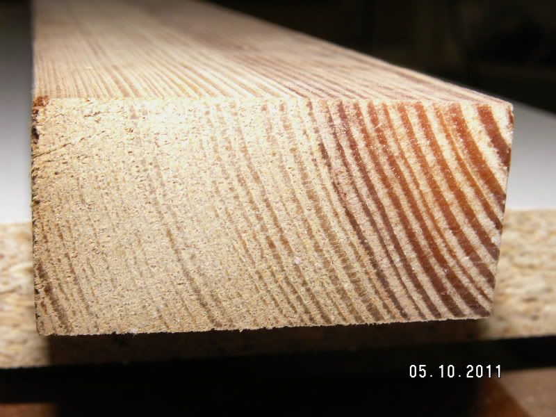

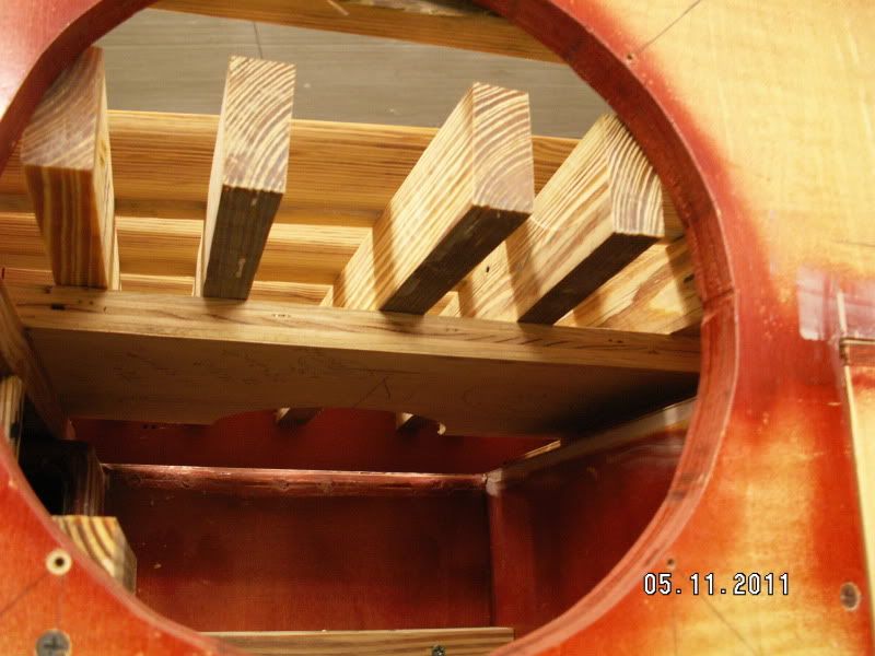

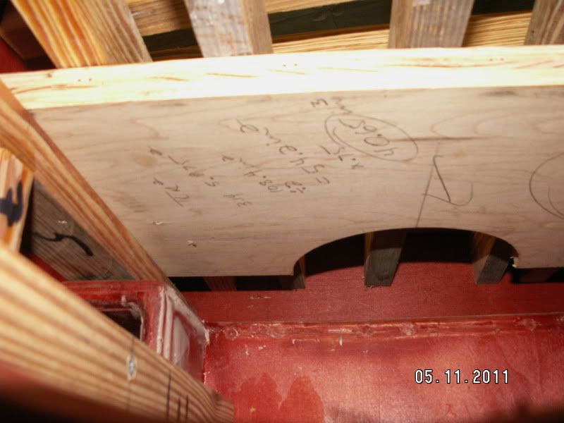

Ah, yes ... the bracing. I have been waiting a long time to brace something ... anything. This is old growth Southern Yellow Pine. It comes from a 100 year old building. Check out how many annular rings there are in the 1-3/4" length. Another thing is that this piece is quarter sawn. As dense as it is there is no way to drive nails into this without pre-drilling. I dragged a few 4"x6" pieces to Eddie's a few years back and milled them all to this dimension to one day use as bracing in something ... anything. :)
This piece in particular is going to brace the vents along the back wall.
I cut the knot out and from the same piece made a brace for the left and right enclosure.
This is the part that I like. This is wood. There is still sap in these pieces. Even after 100 years it still smells like pine. There is evidence of life in this. In this next pic you can see where I cut a hole in the floor of the enclosure and a hole in the base to join the air spaces.
The base will get capped and clad with something ... probably Mahogany, real Mahogany, not the African stuff. I just can't get this worked up about MDF and veneered ply. Cutting that just gets dust and splinters everywhere not to mention chemicals but cutting into a nice wood species is different. Yeah, I know it's weird.

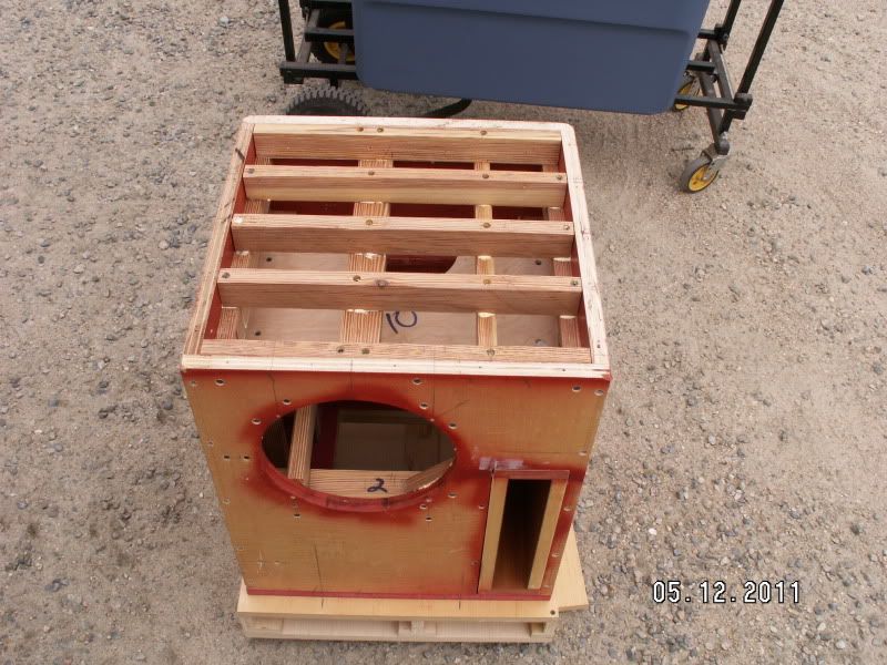

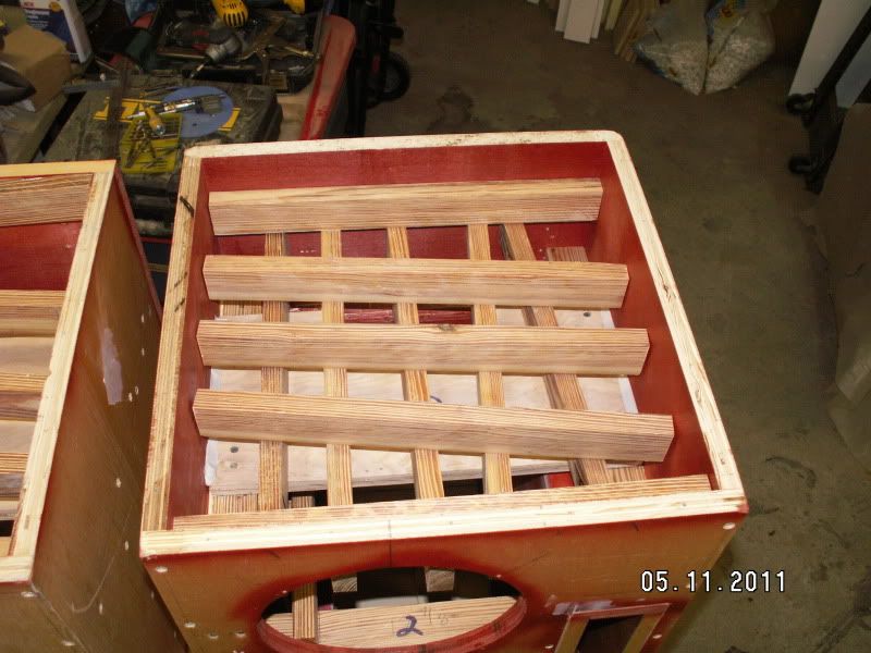

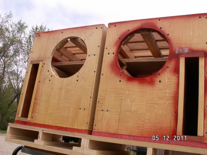

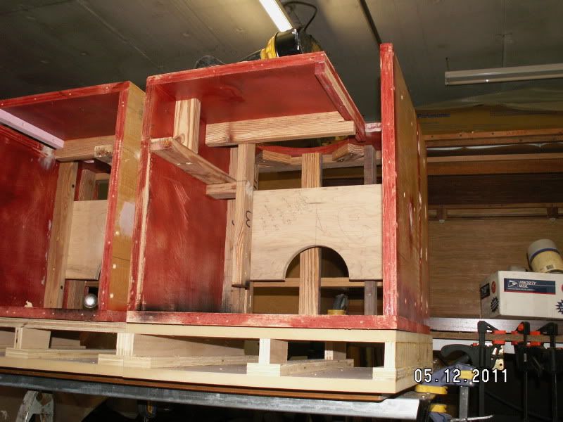

Seeing as how I'm getting all this positive feedback for the pic's here's some more.
I'm going to make a lattice of sorts, raise it up and anchor the top to it.
That should keep it from vibrating stuff off the top.
That plywood anchors the left and right walls.
See that writing? That's the way to dry land. :p
Water World rocks !!! :rolleyes:
I threw a great big fat honkin' bead of silicone on top of the ply mostly because I had an open tube.
Bracing up the side of the box that didn't benefit from having the port run along it was incredibly complicated. It's isolated from the port so that I can still slide the port out the bottom but the pictures don't really help anything here. It just looks like a mess. At least I'm getting to burn up that wood. I think I only have to put another 84 linear inches of that brace stock in to get the Vb where I need it. The total I needed to cram in each box was like 380". That's the real reason for that ridiculous looking lattice on the top. That # was forced on me when I decided to use the existing millwork for the box and the base.
What are ya gonna do? *shrug*
Oh yeah, and with all that untreated pine in the box every time I play bass intensive music it will smell like someone is cleaning the toilet.

Isn't this too big for a pocket sub....
10 inches is still just 10 inches. :rolleyes:
This is an awful lot of work but Swerd and TLS say it's worthwhile.

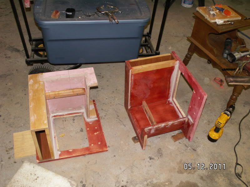

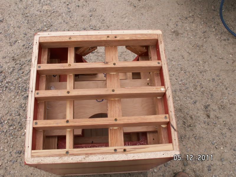

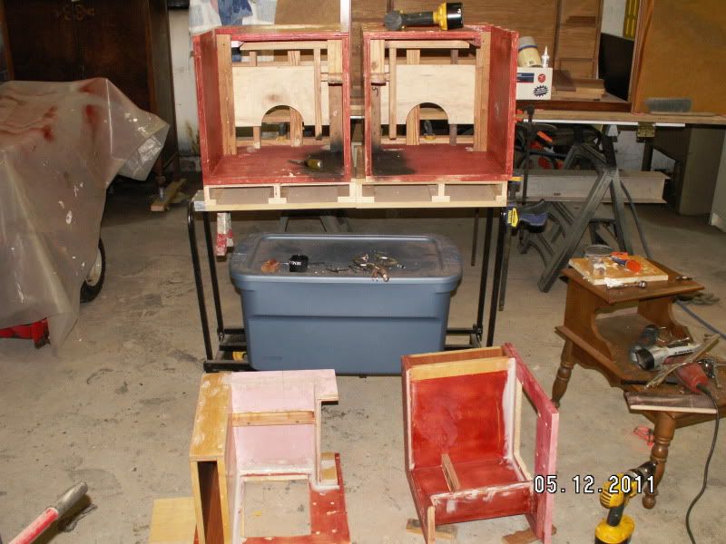

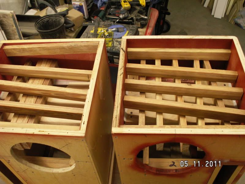

I would have got more done today but I was dragging these things out into the light of day for picture time.

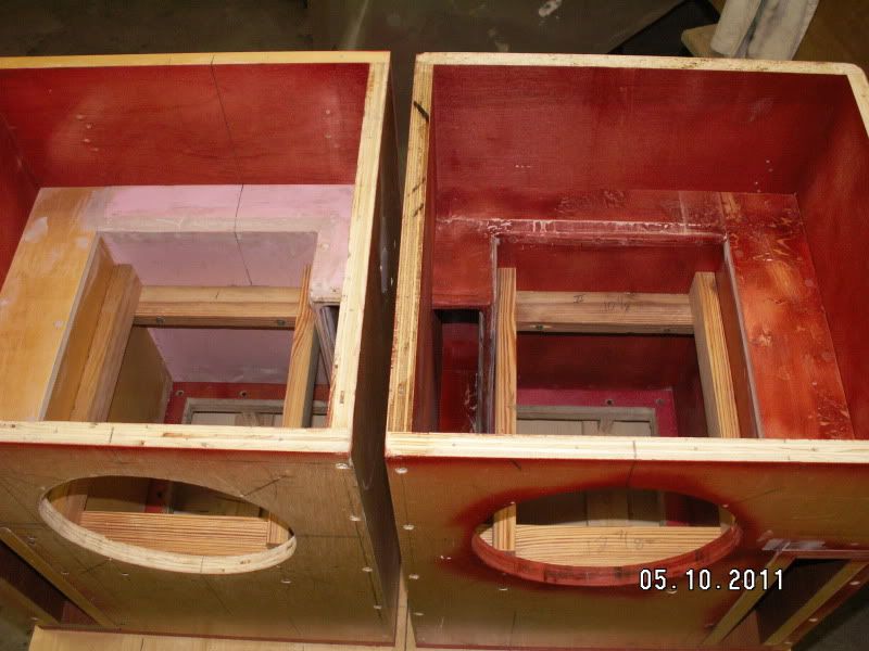

Here's that lattice.

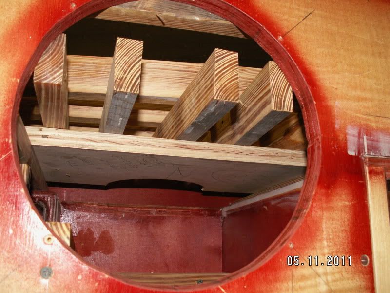

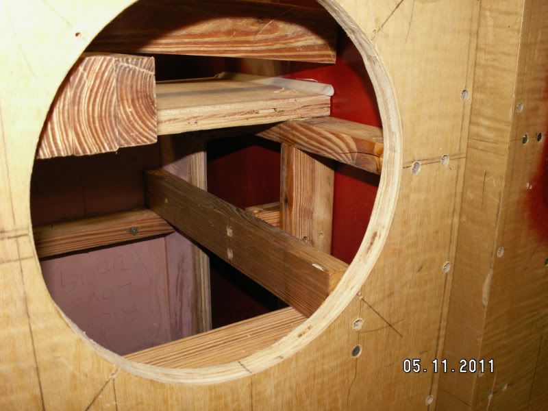

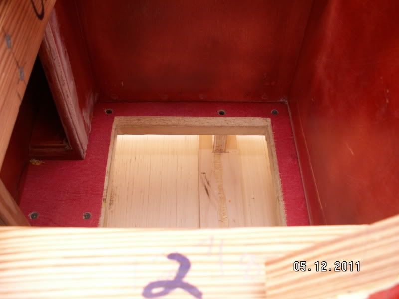

Here's a peak at the bottom of the box. This is next in line for bracing.
It turns out that I need to stuff 100 linear inches of that brace material in there somewhere.
With the top all set it was time to separate the base and yank the ports to permanently attach the port to
the box bottom with glue and the right screws.
I don't understand why GO-NAD! thinks these ports are complicated. :p
It's the bracing that's kicking my @ss.
These things are getting heavier by the day. I may not need a fork lift by the time it's over but a hand truck might be in order. I wanted to be shooting primer by the end of today but I wasn't even close. I still have to make a face and trim out the base after I get the bracing squared away and the cabinet screwed and glued. Maybe by Monday.
It's apparent to me that you could've made these subs quite a bit smaller if you need to throw in all that bracing, in order to get the Vb you need.;) On the plus side, if they don't work well as subs, I'm sure they'll be strong enough to use as axle stands for working on your pick-up.:p
And yeah, that port design does look overly complicated (as in time consuming) to me. :confused: What's the reason for that? Honest question.:eek:
If it looks like I'm picking nits, I'm certainly not trying to. It's just that for me, the simpler a design, the better. However, that may just be a reflection of my skill level, rather than a deliberate philosophy....
I also noticed that you found a use for your telephone stand.;):D

that port design does look overly complicated (as in time consuming) to me. :confused: What's the reason for that? D
I liked the look of the port having a more substantial boundary and being off center and vertical.
I could have made these a little smaller if I had the money to buy a few sheets of plywood and I could have made them much smaller still if I had gone with a much shorter 4" round port with a higher vent velocity. I wasn't shooting for small and simple. I was shooting for fun and free ... so far so good.
The base (an existing piece of millwork) determined the amount of bracing I would use as the unbraced box (an existing piece of millwork) was almost the perfect size but very resonant. I have been dieing to use up this material and now it's mostly gone so that's a good thing and the top of the box should be completely vibration free which it wasn't when I tested the drivers.
