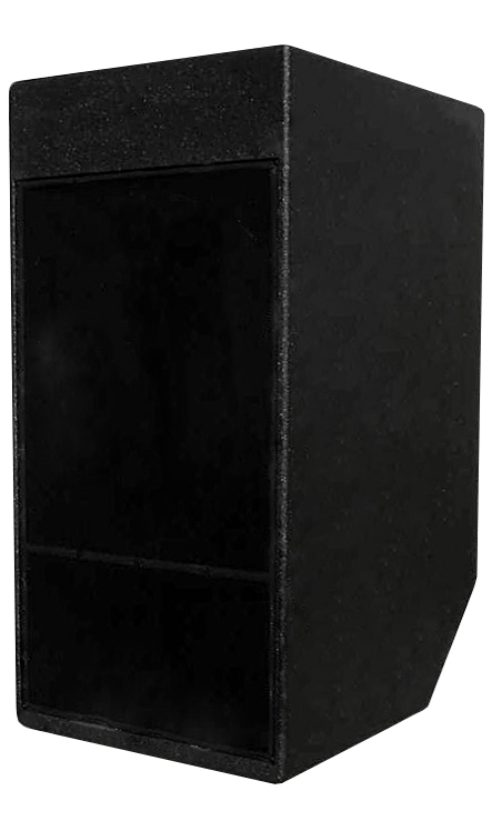

139db (142 if you allow for compression) down to 37Hz.
I give you: the orbit shifter
That has a huge amount of output, but it won't have much in the way of extension and, given the horn-loading, I would also bet the response isn't quite as pitch perfect as the JL Audio subs. It is exceptional for what it does, but it is not ideal for home audio.
edit: oops, I forgot this was actually measured by Josh Ricci, results can be seen here.
