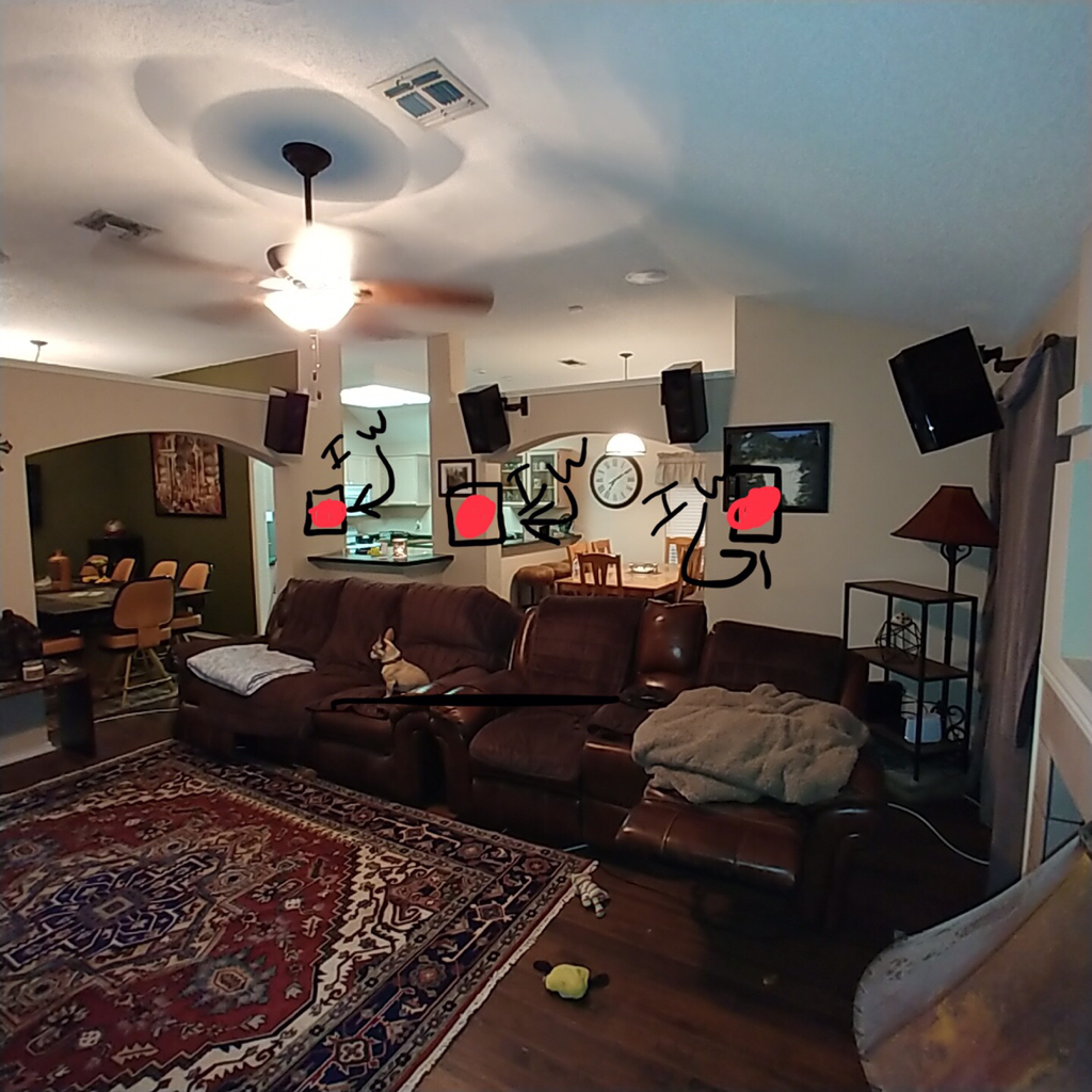

It’s hard for me to tell from the angles but it looks like the locations aren’t where I would like em. I’d fill the holes with new Sheetrock and put the speakers where they should go. But MAYBE sits the camera angle...
The front ceilings are 4 feet in front of my listening spot the back ceilings the same distance they are spread apart the same distance as my left and rights at 12 feet do you think they'll work the back ceilings are kindoff close by those surrounds but they already came with the house so I didn't get a choice where I would have put them. Luckily the RSL C34E's fit those holes So at least I can upgrade them. So do you think they're workable? Any suggestions?
NOW, based on the numbers, it seems they’re closer to where they might work. Better pics?(or better help desk? Lol)
Although I will need go build or purchase platforms for the prime towers one final question then how high up do I need to elevate those prime towers? The tweeter is about 33 inches high my couches are about 41 inches high. Is it just the tweeter that need to be higher or do I need the woofers firing over the couches as well?
You’ll want definitely have them over the seats. The actual height will likely be determined my the couch height. The spec is for “mains tweeter height X 1.25) but I think somewhere around H1x1.55 is ok. Especially if you have multiple listeners, you’ll want to have the tweeters NOT blocked by people’s heads. Here’s a little visual aid.
The problem is mine aren't 5 feet up they are 7 feet up pretty darn high
That’s probably a good height with some angle down and forward for a 7.2 ch system but just too high for Atmos.
I'm thinking probably not I bet they just put them in they're instead of using floor standard they git my attention when I bought the house cus I was like I might be able to use these! :)
GUARANTEED they just wanted something for out of the way.

Also. The 4400 will definitely run your 7.2ch system in the meantime. BUT it won’t use PLIIx anymore. I don’t like PLIIx so I don’t care, but it might be a problem for you. Dsu is spectacular but your layout is not Atmos so I don’t have any predictions on what it would do. Just don’t upmix I guess.
the aimable tweeters are pretty much useless, especially if they’re 14’ off the ground. The 15deg baffle will be much more useful, and one of the reasons I bought them. Also Joe Rodgers entertained all of my questions from super geometric diagrams I made to BS’ing about my LR and moving to California. The guy is great.
I dont like PLIIx either I'm going to go do precise measurements of that ceiling setup so you can have a better idea if they'll work or not

I’m multitasking now so no complete thoughts from me lol...
Ok...
So I marked where it might be feasible to use some decent in wall speakers. Although the spots might be a little high you get the idea.
Then I realized the window is gonna be a problem. So what if you just lowered the surrounds and put them on stands? Then just use the primes on the SVS trade up program. I’m definitely for towers all around but...

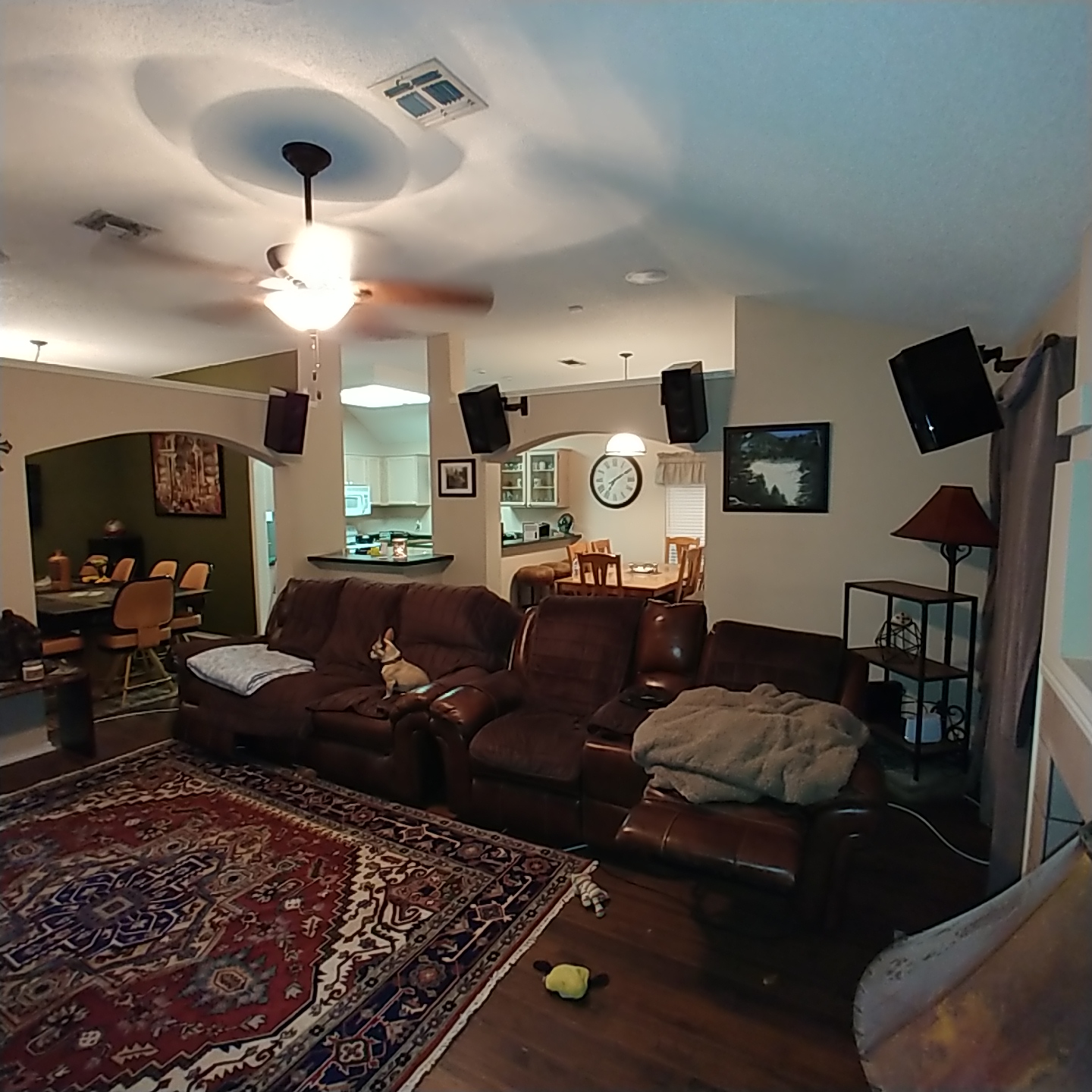

Okay hopefully better pics with precise (hopefully measurements)
The front heights are 5 feet from the couches the backs are 4 feet
The front towers 12 feet apart 12 feet from the sitting posiroom.
Back surrounds 5 feet from listening position.
Ceilings are actually 10 ft high. Thought my agent said 14 damn I shouldve measured before.
The pics were taken from where Audyssey dialed in the best spot at ear level. They may look weird but it was hard to angle the phone just right
Danzilla31
First picture is the ceiling rights FrontH1 RearH2
Second picture is ceiling lefts FrontH1 Rear H2
3rd is the Front H1Left and Front H2Right
4th is RH2 Right and RH2 left. Hope that helps better

poop man. Since theyre there id be using em. If they sound to bright find another speaker that fits the hole. But atmos is just ocasional sound effects so its not they are on all the time. You could always try them and move surrounds later if needed.

Hey take your time I just appreciate everything you've already done for me. That picture explains it a lot better to my noob self. I would use stands because of the window just not with those speakers. They're sealed speakers which roll off at 100hz. What's the point of dual six inch driver surrounds that over extend if you set the crossovers at 80 Hz? I need a ported design that can move some air in that open open space. I have 2 options go with the CG25's when RSL starts selling them at the end of the year on stands which I'm down for. Or use the primes since I already have them when I get the ultra Towers. The RSL's will cost a helluva lot more for 4 then one more Prime Tower. Plus factor in the cost of stands. My sales rep at Bjorn's will give me a much better deal on the ultra's if I pay in cash then what I would get off of trading up the primes. So it wouldn't hurt to keep them.
That's why I'm leaning towards the towers. Those surrounds have limits that I found when you guys helped with the drivers overextending. I want surrounds with no limits. And I'll flip those Surrounds I have now with they're stands to also offset cost.
