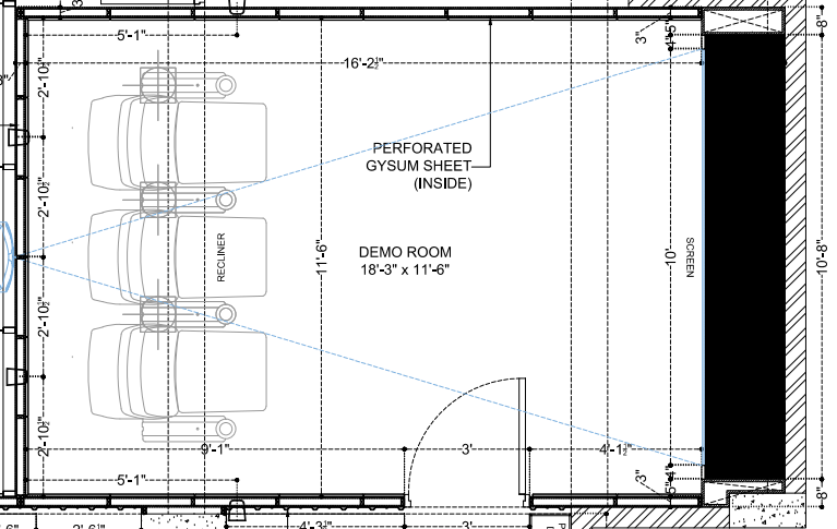

Hello All,
I am building a demo room for our upcoming office and would like to use ceiling diffuser and rear wall diffuser for our THX setup. Probably 7.1.2. I have allotted a space of 6'x4' in middle of room ceiling. Please suggest the frequency to start the diffusion calculation. We are absorbing on side wall by creating 72+22mm thick absorption wall which shall be good for mids and highs. Bass absorption will be done using corner bass traps if needed. Looking for help on this as i understand the behavior of sound but not good at calculations.
I feel to use Inverse skyline in ceiling and QRD at the back.

Without acoustic measurements, you are flying blind!
Additionally, corners represent a pressure minimum with in a room. They are the least effective place for bass absorption.
