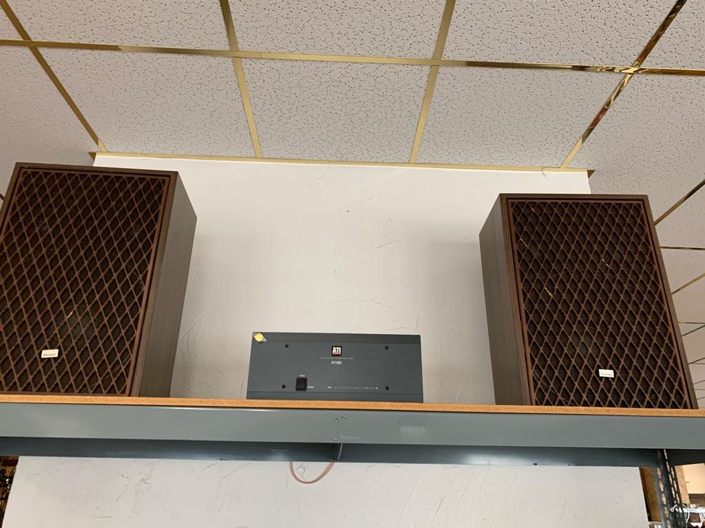

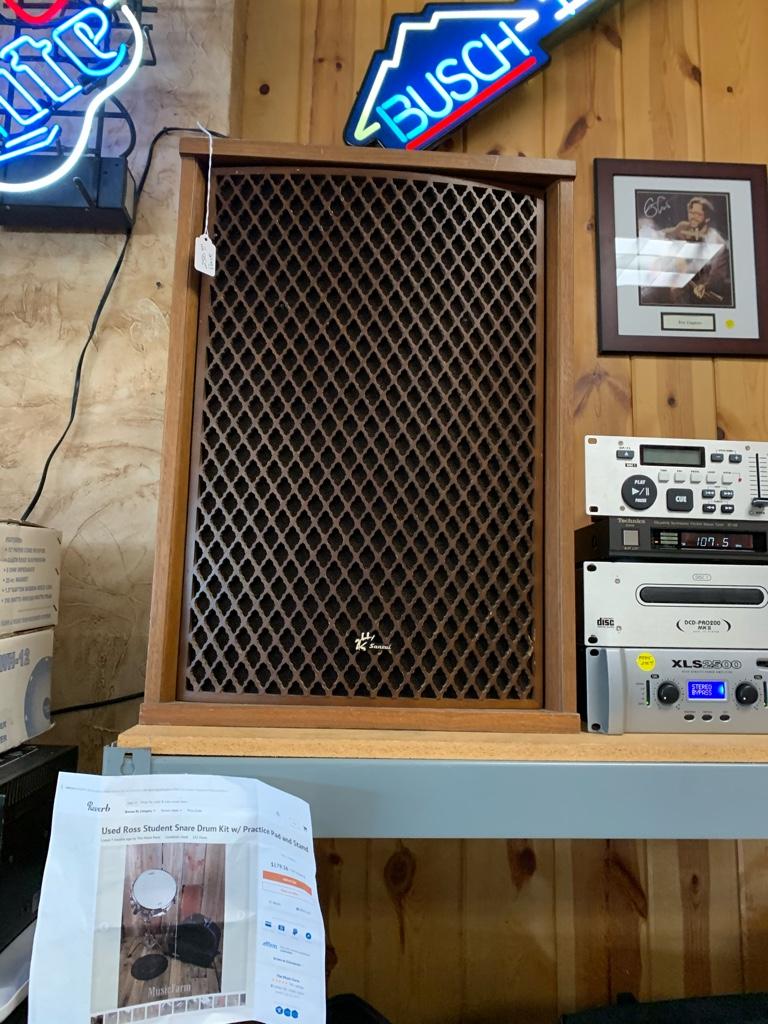

Saw these at a pawn shop yesterday, reminded me of this thread. 250pr seemed a little high, but they’re cool...
5ch ATI amp for 650 bucks. Almost did that!

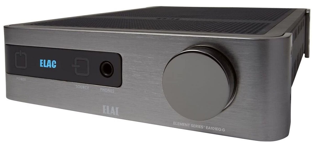

Here's a few that meet the brief. These all have digital bass management/re-direction (LPF/HPF) for properly integrating a sub, as opposed to the common sub out jack that just receives a summed, full-range signal.
Heavily discounted from time-to-time:
Updated version of above; with pre-outs:
My personal pick. World class Dirac Live® DRC:
The denizens of ASR (and elsewhere) tend to hyperventilate over poorer than expected measured performance. However, in the real world the result of these less than stellar measurements when playing program material will be masked by the room's noise floor and swamped by the distortion and non-linearities of the speakers and sub.
Having said that, your overall sound quality would likely benefit from high-passing your LX16's and applying room correction, but the last thing you'd want to do is fork out to replace the Sprout 100 if it erodes your primary system speaker and sub budget.
