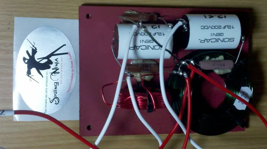

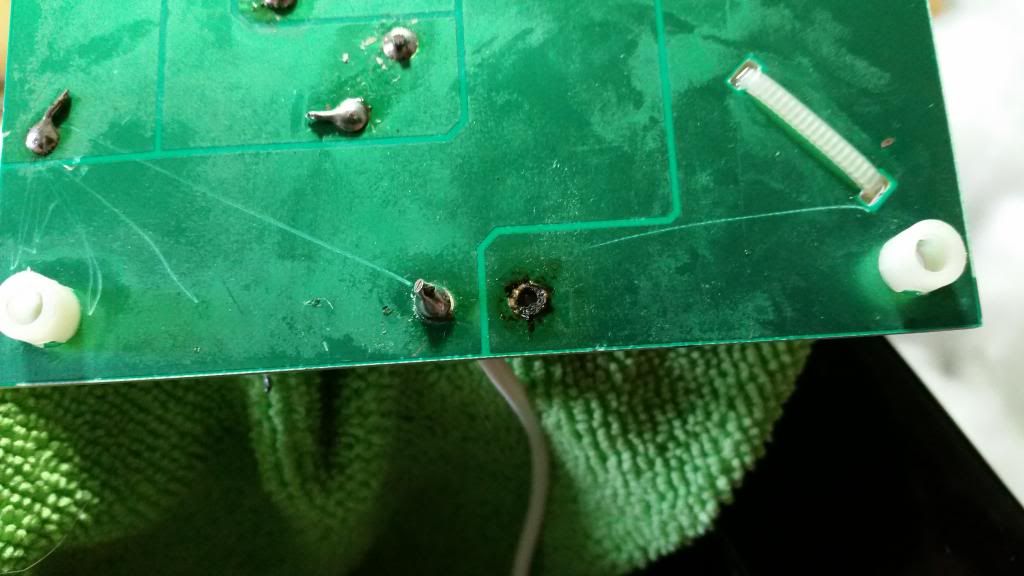

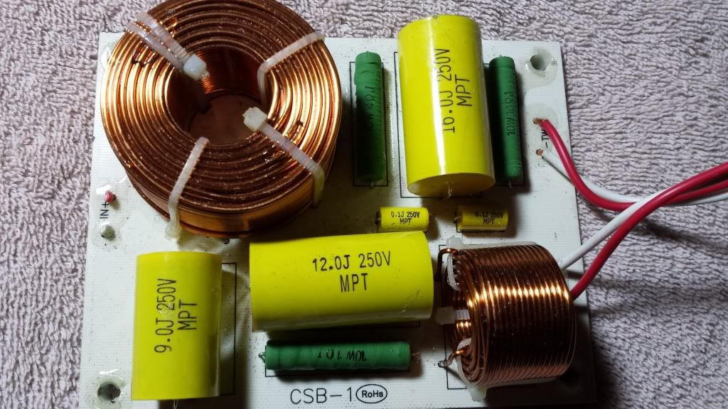

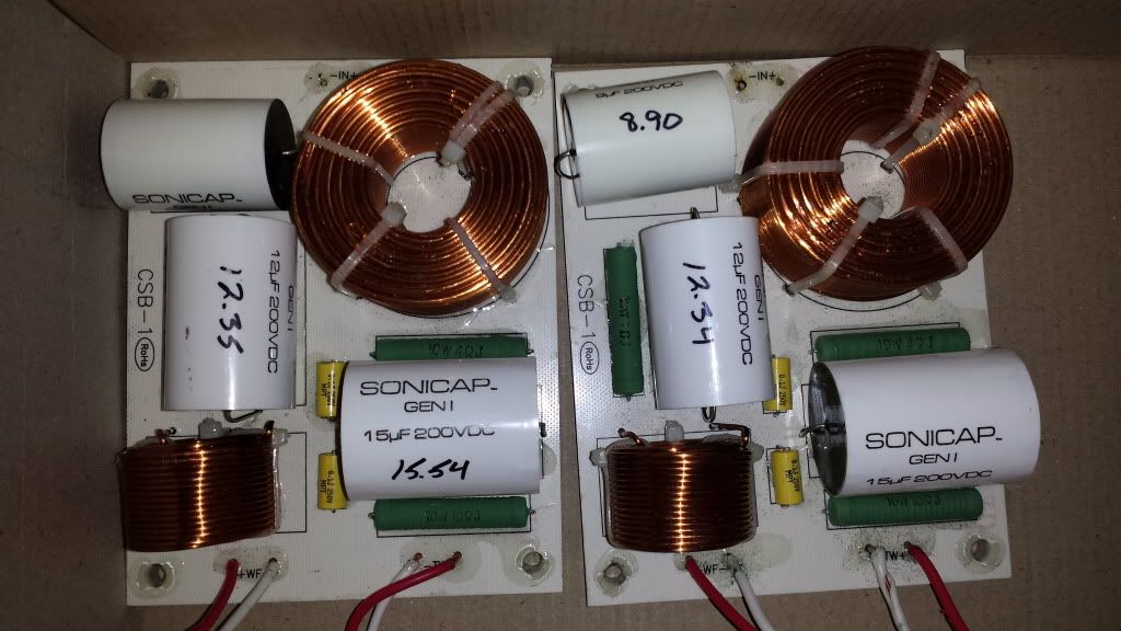

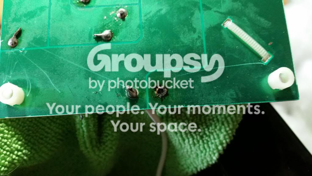

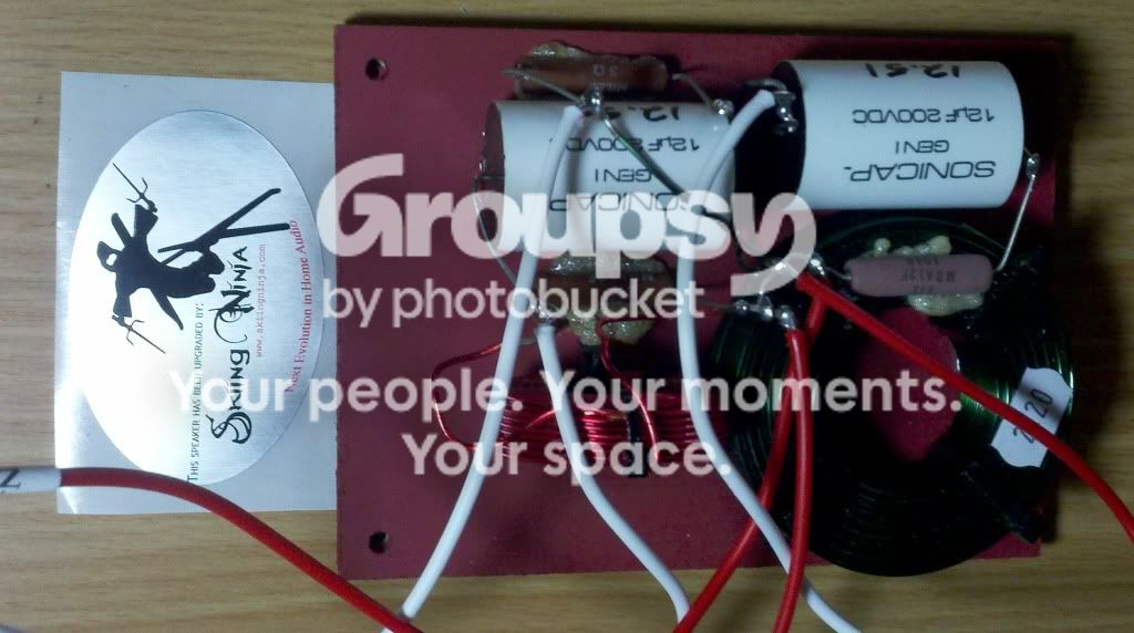

I took my Carnegies apart within a few months of getting them because they were said to have manufacturing "defect" that essentially just required some additional polyfill. While I was in there, I also upgraded the x-overs with an upgrade kit from Danny Richie (GR, designer of the Carnegies). His kit x-overs are normally just inline, but these ones were built on boards so I had to desolder and replace components. The boards themselves had issues from how they were built and I ended up repairing the speaker leads at the same time (one broke, I fixed all of them because they all had the same issue). It took a few weeks to redo them. I don't seem to have the pics of the cabinets pulled apart anymore, but have x-overs
original x-over
Solder traces on the speaker wires popped
Upgraded x-overs
After that...the next ones I had someone build my upgrade x-overs lol. I don't know if Sean the Skiing Ninja is still around because he closed the business because he was pretty sick. He was a good guy and did some nice work.

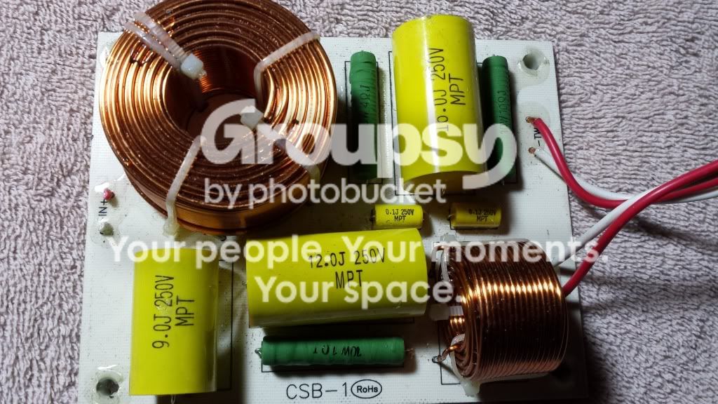

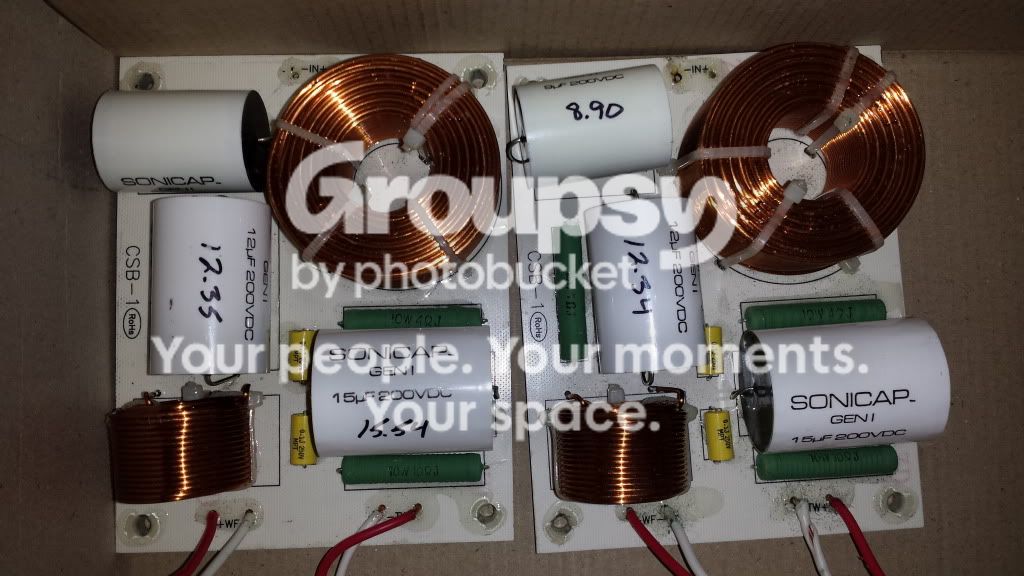

original x-over
Upgraded x-overs
