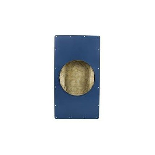

Oh, you're talking about ACTUAL MDF enclosures, not these $75 FOAM boxes that LOOSELY fit around the speakers.
Yeah, I can see the benefits here. But these actual real MDF enclosures will cost A LOT more than $75.
The OP is talking about $250 in-wall speakers. So I doubt any of them will come with real engineered enclosures.
I was talking about these $75 typical loosely made foam enclosures:
But you are talking this:
This is the RBH SI-831R Reference in-wall used in Gene's new house, which is equivalent to the SV-831/R free standing cabinet of the $45K SVTRS towers that Gene has. Definitely not $250. :D
Where can you get those foam enclosures? I at least need to get something behind my mains in the theater. Losing a lot of bass.

I know RBH sells them.
I saw that on their site. They're specific to their speakers so I'm not sure if they'd work for me. I may just get a big roll of acoustic foam and make them myself. If not, I'll PM you and see if we can find some that might fit.
Yeah, these foams are pretty basic. The in-ceiling sizes are more standard since they are all round shaped. And you can use the 8" or 6.5" foams to fit all the sizes that even smaller.
The RBH FB-W (in-wall) enclosures are 31" H x 14" W x 3.5" D. So as long as your in-wall speakers are no bigger than that, it should work.

Haven't been able to find them for the large in-wall cinema speakers. Going to have to just build something. Don't have much space behind, but the roll up foam should work to at least contain the sound and prevent it from getting to the outside.
