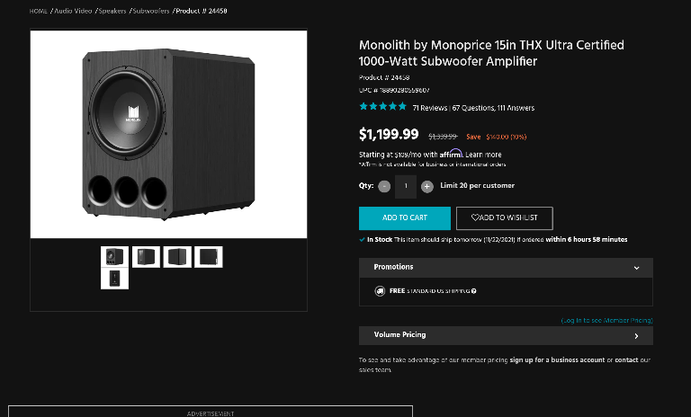

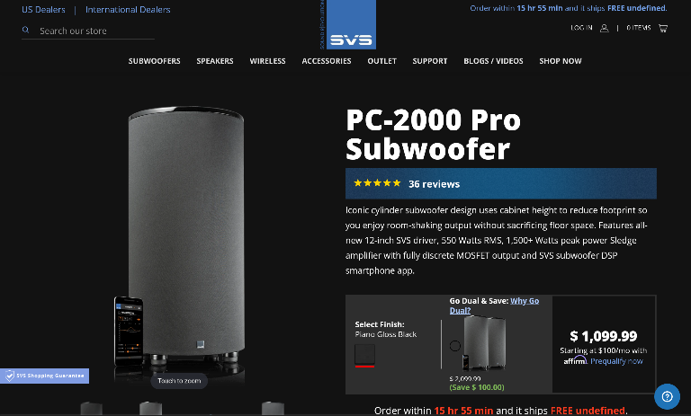

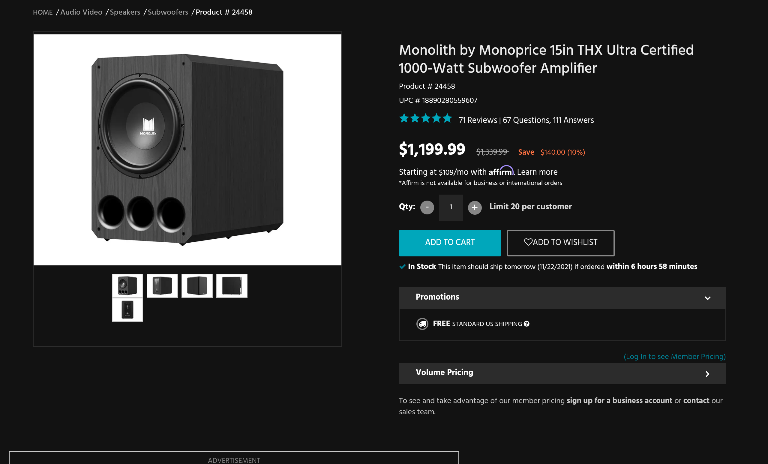

My biggest hangup is the price. This is what I see I look at the cost of these Iso's...
Good point and I agree. IMO tweaks like those big dollar isolation devices while they may in fact produce a benefit, for most of us there are far better avenues to go down first. Regardless I for one have got to believe that one can accomplish equal results for less $$, if in fact ones flooring concerns warrant such.
