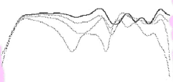

Agreed but as you can see in the measurements, the MTM I measured didn't exhibit such behavior when measured 27 deg off axis (more like 5dB dip from 1k-5kHz but actually looked flatter when compared to the entire frequency spectrum).
Also note my comments below about the measurement:
At this measurement position the MTM measures very similarly whether oriented horizontally or vertically with the exception of a 5 dB boost centered around 2 kHz in vertical orientation. Arguably the MTM measured more linearly at the primary listening position when horizontally placed. As we indicated earlier, the reduced output of the off-axis MTM is actually beneficial when the listener is placed near a sidewall. The two-way again measured nearly identical to the vertically mounted MTM. Hence even sitting near a sidewall we see the MTM does a good job whether placed horizontally or vertically. It’s important to note that this is a very well executed MTM design and your mileage may vary depending on how well the manufacturer executed the crossover and chose the correct drivers to match the system.
All speakers exhibit lobing to some degree even W(T/W)W designs. MTMs tend to be worse, but well executed designs still have merit as center channels, especially if the listening seats are under 30 deg off axis, which most are in home theaters!
I invite you to read the conclusion of my article that provides some practical and useful guidelines on the topic.
In an acoustically dead room, where side wall reflections are completely absorbed, this might not be a problem.
But in an average room, or an acoustically live treated room, what kind of reflections are you getting from that MTM?
27 degrees is NOT the second reflection or even first reflection, horizontally.
Measurements out to 60, maybe 70 degrees are necessary to determine how a speaker behaves in a room. I'm still waiting for AH to start measuring polars out to 60 degrees. "Subjective Stereophile" measures out to 90 degrees and even 15 degrees vertically ;P
You pointed out that the lack of side wall reflections in the midrange might be a desir-able trait, but the tweeter is still reflecting off the side wall like crazy.
The only way an "MTM" center would work and still be balanced sounding, is if it looks like a mini-version of this:
Then you can say the side wall reflections are inoffensive, because there's an effort to focus on the power response out to 60+ degrees, by guiding the waves on the tweeter to follow closely to the wave behavior of the woofers,, which are tilted out a little bit. There will still be a narrowing of directivity as they go from omni to monopolar, but no switch BACK to near-omni at the crossover point.
It's still not as optimal in terms of consistent off axis response as an acoustically small dipole like three Nao Notes but at least there's an effort to control what's going on, rather than just living with a very narrow directivity accompanied by tweeter bloom. You really want smooth sound power response, not just adequate listening window response which is what 30 degrees would encompass.
"Living with it", to me, sounds like a cost-cutting maneuvre, which returns us right back to the article. MTM centres are an easy cost compromise to make but while I don't agree with DS-21 on a lot of things he said, this is one point where he's correct in that a (high end) speaker would not use an MTM center speaker.
Even the W|TWTWT|W on the RBH center you use, makes a lot more sense, or at least I would hope with the right crossover(where the inner woofers play higher but the outer woofers come in later) but without 60 degree polars and without having heard it, I can't say anything about it.
You got it backwards. Ill effects of lobing are more prevalent in an anechoic environment since sidewall reflects won't be present and thus influence the measurement.
Maybe I'm thinking of this wrong, AFAIK, if you sit on axis, the MTM drivers should be in phase (not lobe, minus maybe from the crossover to the tweeter)
The major lobing is off axis and pretty consistent to the point of creating a power response suckout.
What you're thinking of, is where a smooth power response might "fill in" a flawed listening window response. But in a reflective room, it'll do the opposite because an MTM will not have a smooth power response (whether that's vertical or horizontal) - instead it'll "fill in" above and below the lobing region for an imbalanced timbral presentation.

The frequency response, at 70 degrees off axis, does not have a 20db relative null in the midrange:
http://www.avsforum.com/avs-vb/attachment.php?attachmentid=162690&d=1262683339
Compare the above, to a typical horizontal MTM,. and note specifically the tweeter's wide directivity coming into play:
