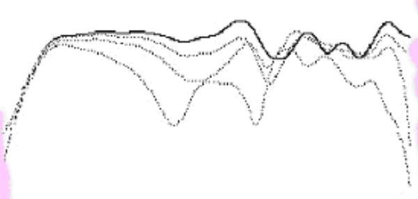

The frequency response, at 70 degrees off axis, does not have a 20db relative null in the midrange:
http://www.avsforum.com/avs-vb/attachment.php?attachmentid=162690&d=1262683339
Compare the above, to a typical horizontal MTM,. and note specifically the tweeter's wide directivity coming into play:
But if Dr. Floyd Toole says that MTM centers are A-OK too, then who am I to argue with him? But then, Harman only has a few speakers I can think of, which ostensibly could be called an MTM, and all of them are bottom-of-the-line budget offerings.
