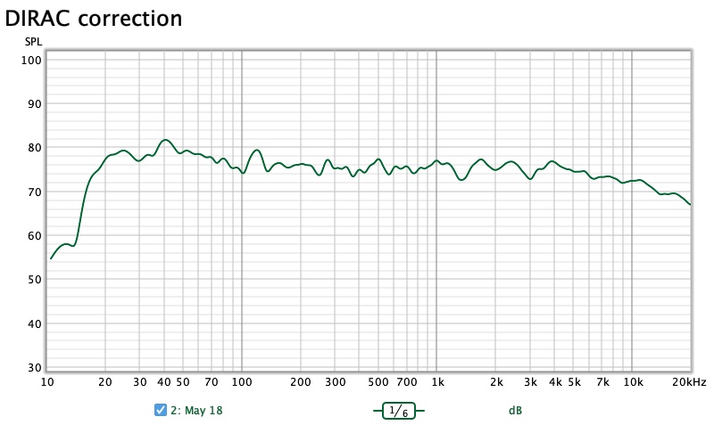

But Dirac rules, here's my latest REW measurement....
Paul McNeil
Well, it is a REW measurement, in room response, stereo, from my Revel Performa F226Be left and right speakers, and five subwoofers.

But Dirac rules, here's my latest REW measurement....View attachment 67686
Looks good, but as mentioned before, for the deep bass range, it is better to use less smoothing, such as 1/24. I like to tweak for pretty graphs so I would use no smoothing, in order to identify the dips and bumps, though 1/12 should be good enough, but I wouldn't use 1/6, ymmv.
OK, got it...and here is the 'no smoothing' response...

That's excellent, the only tweak I would do to this would be in the approximately 60-280 Hz range, it might help result in a so called "warmer" sound.
