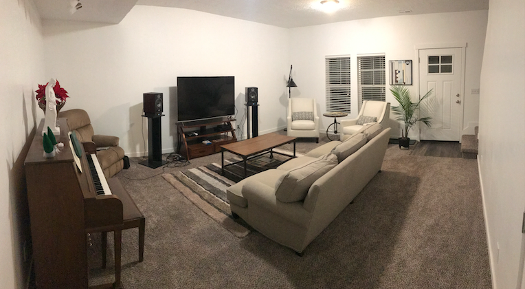

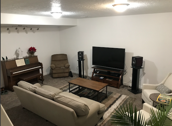

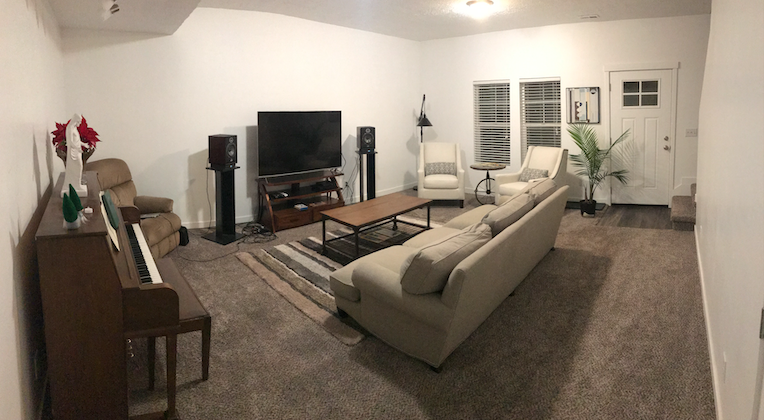

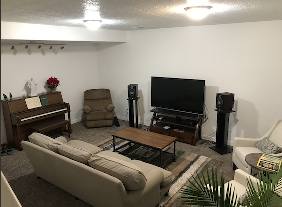

I have considered getting a single SB-3000 from SVS because I can pick one up for $999, but my concern is that having a single sub won't allow for a smooth response. Can you check out my living room pictures below and tell me what you would do with that room?

Here are some picture so you can see what I'm working with:
You'll notice it's a mostly enclosed room with the only opening being the stairwell on the far right.
