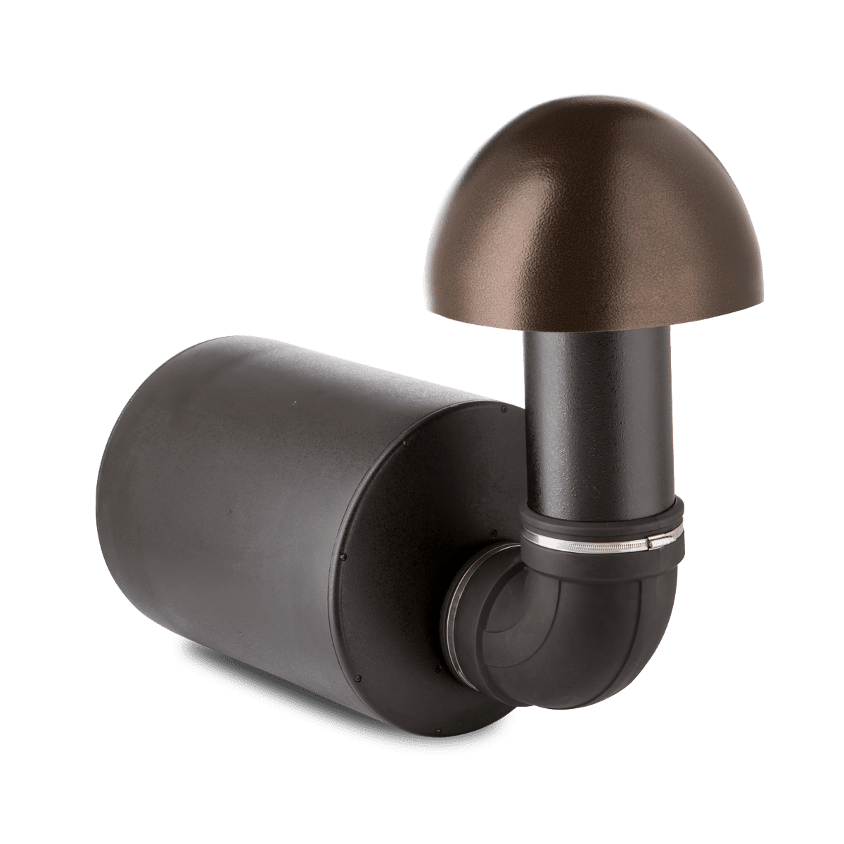

Paradigm has the Garden Oasis speaker system. Specifically made (with a subwoofer) for outdoor garden spaces. I'm sure other manufacturers have them as well TS.
I don't own them, nor have I heard them in use.
That is very expensive. The sub is passive, as I think you would expect and they list a matching Crown amp to power it.
The sub looks like the air intake and cleaner off a vintage tractor!
1958 JD 420 we had at our lake home, along with JD model A.
