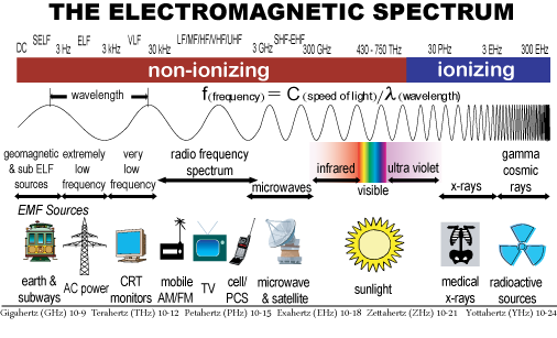

- MVW and I have the same problem with our Anthem’s. Were on this post to see if anyone has had the same problem, what resolved it and what it cost to have it fixed.
- I actually have an Electronics Engineering Degree and nearly 50 years experience, I do know what I’m talking about.
- Mgood's problem is different than the original post, his sounds like the TV produces EMF radiation (or EMI: Electro Magnetic Interference) getting into the Anthem. Could be the proximity of the TV to the Anthem or cabling locations. It has nothing to do with “Harmonic Resonance”.
Here’s the lesson you must have missed when you went to college:
Electromagnetic Field (EMF) Radiation Spectrum
EMF radiation can be classified from very low frequency (long wavelength) to very high frequency (short wave length) as show below.
I'm out of here!

In the EE world, EMF generally refer to electromotive force, so it is better to refer to electromagnetic interference as EMI. The effect of "EMI" is more appropriately described as interference (I) than force (F) anyway. To be clear, it wasn't the terminology I wanted to discuss/or argue with you, but just wanted to be sure if you were referring to EMI when you used the term EMF. I thought I was polite and open minded on this and I am sorry if I offended you inadvertently.
To @mgood , WMH could be right as EMI could certainly do something like that too, I didn't think it would be in you case because I thought people don't typically put their AVR so close to their TV such that the EMI effects would be strong enough to result in such audible hum, but may be you do...
I never said (or at least meant to say) it was harmonic resonance as that would be the worst case scenario only. It does not need to be in resonance to create the kind of noise. I cited my own experience with my desktop humidifier that was in another room more than 15 feet away, separated by a wall, and that I knew for sure was due to harmonics, not EMI, obviously the expression ymmv/mgood's mmv applies here.
