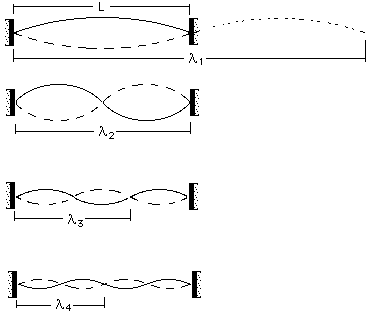

And so it is. If 40 Hz is the fundamental then 40Hz X 1 is 40Hz. So that is the fundamental frequency. So 40 Hz X 2 is 80 Hz which is the second harmonic.
Here are the modes of a vibrating string.
An open string can produce all harmonics, as can an open organ pipe.
A closed pipe, that is a pipe closed at on end will produce the fundamental and only the odd harmonics.
