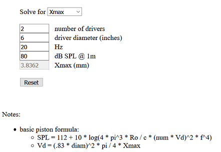

The membrane should travel almost 4cm in one direction to achieve 20Hz (THAT'S 20 not the stated 11!!) And almost 8cm looking both ways. And that's for less than useful 80dB.

If I see exact measurements for this, I'm perfectly willing to take it all back. Until then, I CAN'T and DON'T believe they found a way to outsmart laws of physics.
