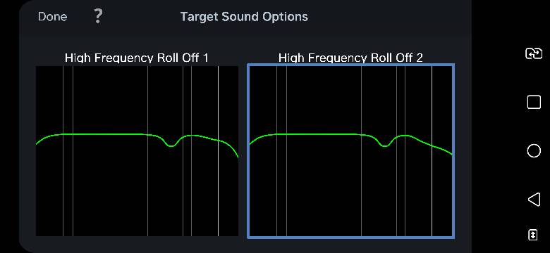

Sachb
The treble felt little harsh so I changed the target sound options to High frequency roll off 2 in multeq app.
Now it sounds even better.
Sent from my LM-G710 using Tapatalk
Reference Equalizer seems odd and has a boost in higher frequencies.
I read somewhere that XT and lower models boosts certain highs which might give you a bad experience.
I was thinking what would XT32 do to my speakers.
I will find the link and post soon if i find it.

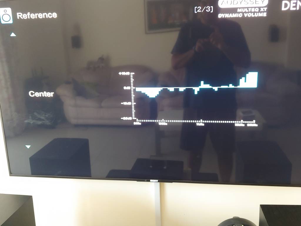

Hey what’s the process to bring up that graphic on screen? We covered it before but I’ll be dipped if I can remember how lol.
Sachb
The strange thing is that my old Sony hifi system never needed so much tweaking and sounded right out of the box when my dad bought it first.
But I guess Denon is overall a better equipment.
But the sony had a slight edge in 2 channel music listening.

I think you remember wrong, flat would boost the highs more as it targets "flat". Reference would target some roll off but may still boost the highs depending on your speakers in room response.
Did you read the Audyssey faq threads? It's a good source of info.
Sachb
I could hear some artificial treble (sibliance) when high roll of was set to 1, setting it to 2 solved the overwhelming highs.
I also prefer MRC on, as my room is too lively.

How i know whats the right roll of for me ? 1 or 2 , default using avr calibration is 1 ?
