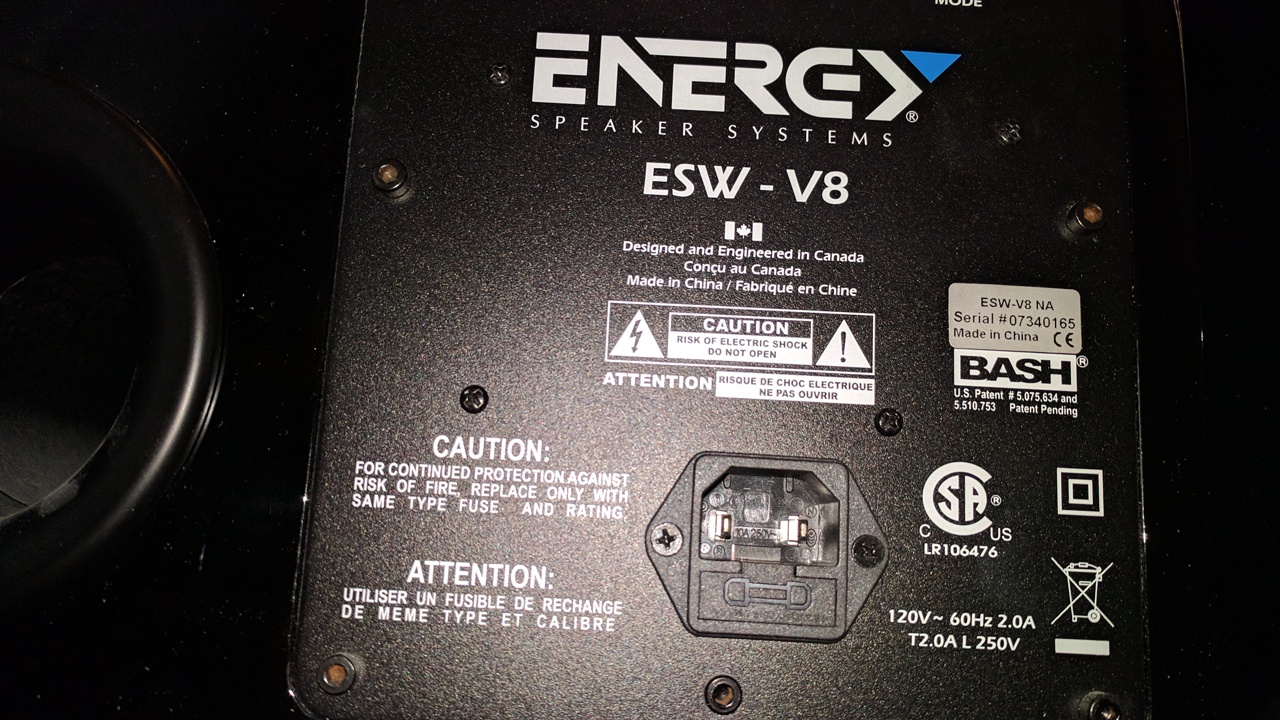

I have a stupid question.. Any help will be appreciated.
I wanted to remove the Bash amp yesterday, but after removing all the perimeter screws, in fact even all the screws, it would not come out. I have not tried to ply it yet because it would have made major scratch marks for sure.
I even removed the driver so that I could twist my arm up and gave the stupid thing a couple bangs from the inside, it still wouldn't come loose at all. Am I supposed to try some sort of jacking screw?
Thanks.

Can you remove the power plug completely to get some pull through it. The seal used around cutout sets pretty good after usage. I removed my audio input plate on my Epiks, which was close the top corner, and pulled from there.

I suspect there is a gasket between the amp and the enclosure. Often these deteriorate over time and turn to "glue". I would get a brush and soak the outside rim with alcohol and keep it wet for at least 20 minutes. Then try and remove the amp. Alcohol will denature anything sticky and not take the finish off hopefully. Also the set up will not reharden. Acetone or other ketones, will almost certainly take the finish off and will reharden like glue if allowed to dry.
You might have to use a bit of persuasion even so. You might have to put a piece of timber in through the speaker opening and on the front of the amp case if it has a complete case, and hit the wood with a soft hammer. I like the type of soft hammer that is packed inside with small steel balls. You get better more gentle impact with those.
Even then you might have to pry it out. I would use a putty spreader.

Glue, did cross my mind, a melted gasket may do just that, thanks.

Curious, why are you taking the sub apart?
It has been making quiet rattling/hissing noise for months since the auto on/off had failed. Yesterday it stopped making sound, but started working again after I tried to open it up, still has that noise. I want to see if there is anything obvious and repairable. If not, I will replace the amp.

I would put the inner screws back in place before "persuading it". It is a safe bet that they hold on a sub board that may cause damage if it "falls" off of the plate.

I think if PENG can really get the alcohol to seep under the rim, it will come out without damaging persuasion.

I would like to thank everyone who responded, what a great forum! @TLG Guy was right on about the gasket, it was compressed to the point I could see it acted like glue.
After a good night sleep, I decided to give it another quick trial. I remove the binding post caps to exposed the holes, then I put a good size hex key through them, 2 holes at a time to ply the plate loose. On the 3rd ply it popped right out. By the way, I tried hammering it with a rubber mallet before and it didn't work no matter how hard I bang it. It might have helped the hex key step though.
I may be the only one who has such stupid problem but I thought it wouldn't hurt sharing the trick that worked in this case, without the risk of scratching the shiny black finish.

You see anything wrong with it? Or are you just going to get a new amp?

I don't see any signs of trouble and won't waste time to troubleshoot blindly. For $180 I am going to pick up the amp this Friday. I hope they stock the LED status indicator too because that doesn't seem to work now after I had it removed and re-installed a couple times, may have kill it with reverse polarity.

I checked the LED status indicator today and it looks fine, so it must be just the amp, that is totally dead again after I had it out and back in. Funny, the first time I took it out and put it back, it came back to life, yet when I did it again the second it went back to death. There is no loose connections or anything that I can see.. Even when it was working it was making weird but quiet noise, so it's got to go regardless.
