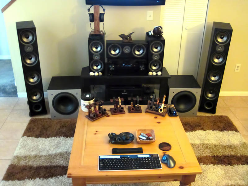

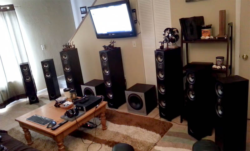

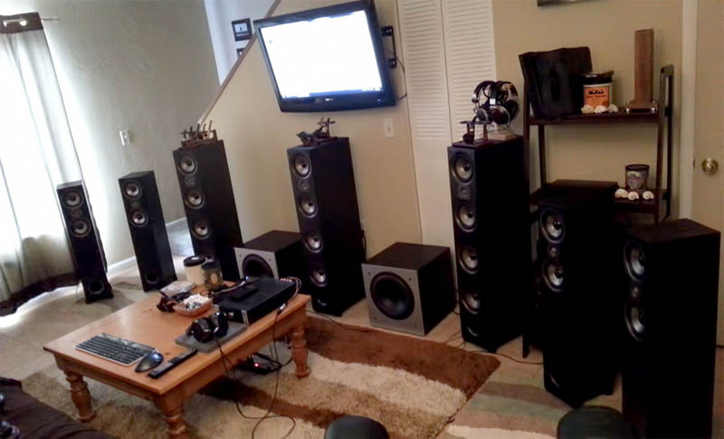

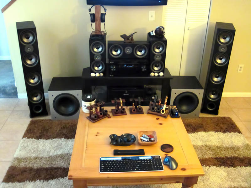

Before the kids, I did play around with different configurations for the heck of it, just to see how well I could get a fleet of the matched speakers to perform at low listening volumes (I had neighbors in a condo back then). I mainly toyed with different center channel configurations too. I found the experience certainly different than just a pair of bookshelves, but I can't honestly say it was unobjectively better.
I'm attaching some examples, for everyone's amusement... This is not my current arrangement as I'm in a house in the country now and have significantly down sized what's in the living room and commonly just run a stereo setup with several subs.

Looks like how @Danzilla31 had his living room setup. Except he eventually replaced his small tv with a big projector screen. :)

That poor old small 37" LCD! I've since moved on to a larger 4K television, but it's nothing special.
